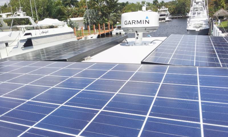

    I have been doing some research on mounting some solar panels. Where are your panels mounted? I assume they are on the roof or bow, so do they hold up to the the weather pretty well? I have built a small solar batt charger for my ham radio. I don't think it would be to much sweat to build a bigger circuit.
  2. NYCAP123
    11,209
    Keep in mind where you might step as you move around the boat or where your honey might want to lay out. Then there's boat washers, and what the next potential buyer will think about it. The reason for going solar is to save fuel. That doesn't sound like it's your concern.

  4. P46-Curaçao
    P46-Curaçao Senior Member
    Mar 8, 2013
    734
    They are mounted on top of my hardtop, 3 Kyocera 245watt panels.
    It's not only saving fuel, it's always (even with little sunlight) charging your battaries. You need an extra bank for sure, don't run an inverter on your engine or small house bank!!
