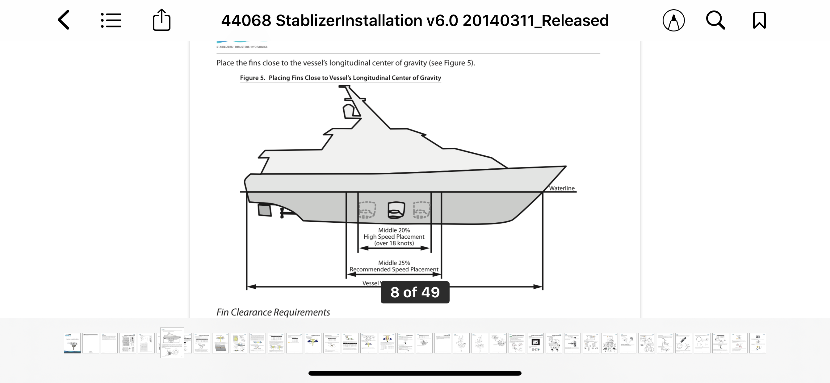

  18. Pascal
    8,946
    FFBC69FE-0713-4E1D-9C43-F56BCA03E9AA.png The installation manual recommends installing them amidship
  19. Capt J
    14,896
    Pascal, yes. On the 76' Lazzara the forward fins are midship, or even aft of midship, and the rear ones are not that far forward from the stern, around 10-15' from the starn is where the aft ones are.
  20. mike Hartley
    mike Hartley Member
    Jul 22, 2016
    52
    nj
    Im am told they get moved about 8 ft or so forward of the rear gyro gale ones...so yes seems more amidship...thanks for that Pascal and Capt J...
