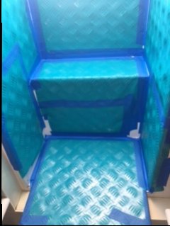

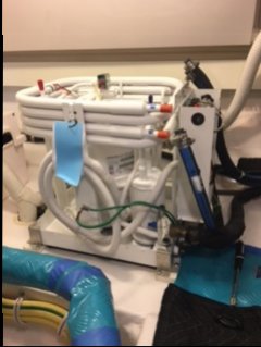

    Follow up. I used Comfort Air in FTL and replaced the entire unit. Everything was covered with cover guard. Not a nick on anything. On time and on budget.
    All of this is unremakable but it's nice to work with pros that do the obvious stuff without asking.
