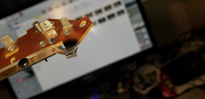

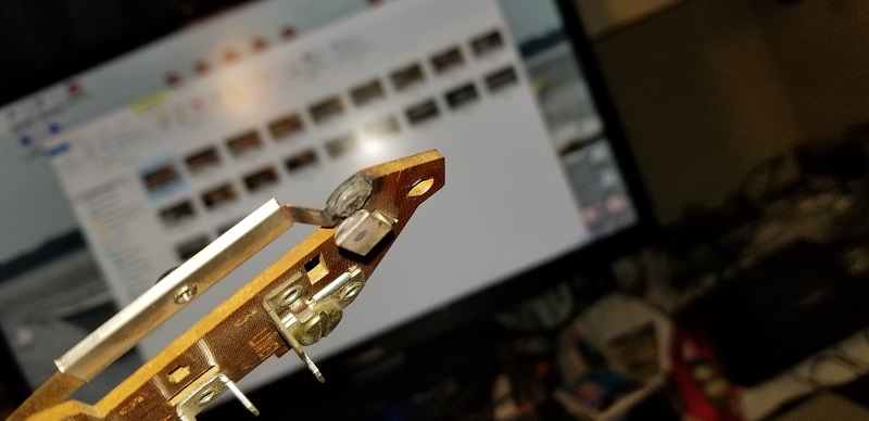

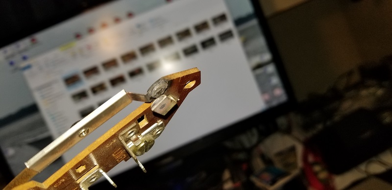

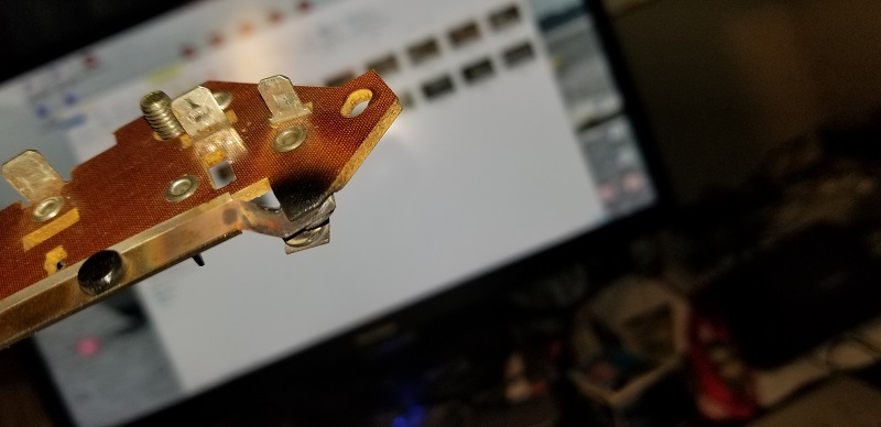

  11. Capt Ralph
    12,749
    Looks like the start contact had arc'd and stuck together.
    Motor could not go into normal run mode when the RPM came up.
    If I can find a new contact board, I may be off and running.

  16. Capt Ralph
    12,749
    Found some hooch and Frankenstein'd a bit last night. Old pump motor starter contacts renewed and working fine tonight.
