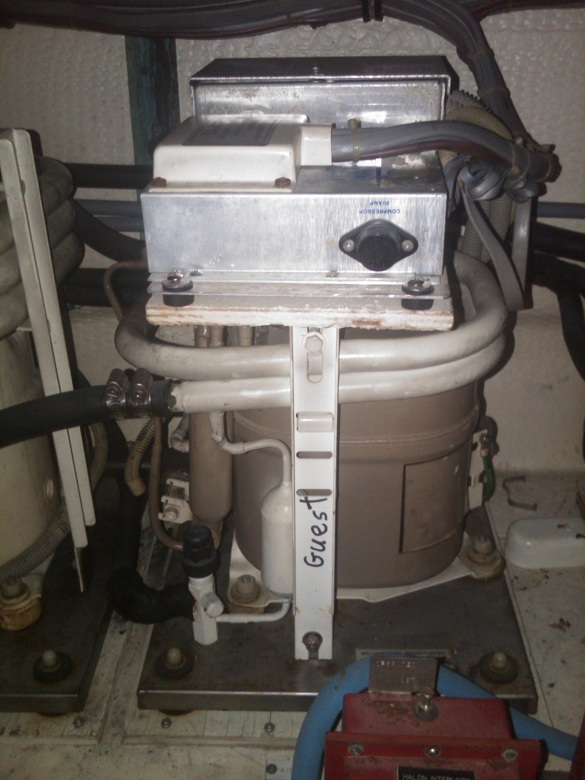

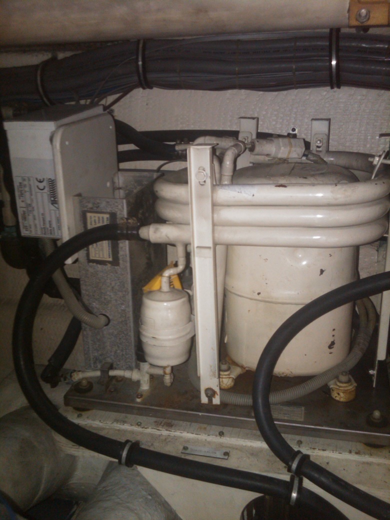

    Hello all, I hope you survived the winter by going somewhere warm!
    Issue:
    Last season one a/c compressor failed (I thought my halon discharged) but it was the compressor.
    Unit #2 is working fine.
    Unit 3 blowing but it keeps needing recharging.

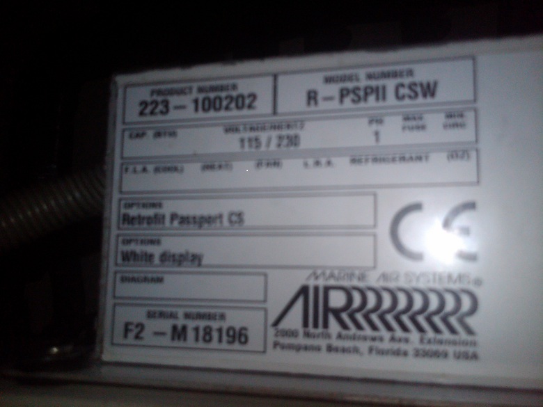

    The system is a Marine Airrr a/c system which isn't in business.
    The boat is a 1995 Hatteras 50 SF
    Does anyone know who rebuilds these? The problem with changing out everything for new is that the controllers would need to change which means headliners, wall panels etc, etc would have to come down.
    I'm actually thinking that any a/c place could do it as I've seen very similar compressors in home a/c systems.
    Thoughts?
    Thanks,
    David

    Compressors can not be rebuild as they are sealed but the condensing unit can be pulled out and the compressor replaced with a new
    No big deal, had it done a few times on various units
    Now if the problem is that the system needs frequent recharge chances are it s not the compressor but a leak either in the piping between the condensors and air handler (often at connectors) or at the air handler

    Marine air was bought out by dometic, same as cruise air. Don't rebuild 20 year old junk, trust me, you will still have junk. Other parts like the condensing unit don't last any longer and you'll have nothing but future problems. Spend the money and buy a complete new unit and have something you don't have to worry about fixing for many years. Also, if the compressor went bad, it most likely sent debris and crap through the lines and condenser. If it's a shorter run, replace the lines also. Then you can fix something and not have to worry about it for a very long time.
    Unit 3 may be the heat exchanging coil and it's leaking into the saltwater side. You need to fix the leak, or the system loses the oil in it with the leak and you keep adding freon but no oil charge and eventually the compressor fries. If this is the unit with the bad compressor and you have no visible oil leaks/stains after adding so much freon just change the whole unit.

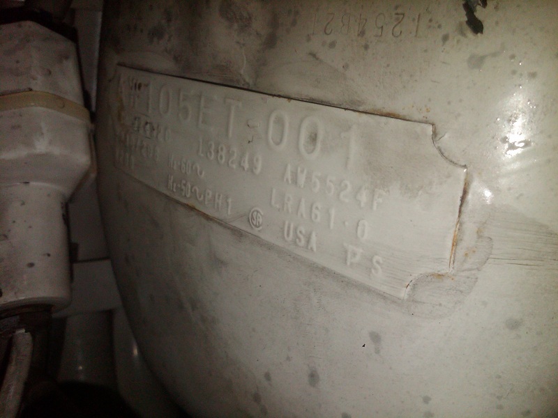

    In the first picture in this thread you can clearly see that the LRA is 61.0 amps.
    That means that compressor can not draw more than 61 amps under any condition.
    Since you said it runs for a time you need to start tracking down the problem. First google the compressor model number on the metal tag and under electrical specs they will give RLA (running load amps) or a FLA (full load amps). Also get the factory spec ohms readings for the 3 poles,start, run,& common. Plus get the microfared or uF(they mean the same) size of the capacitor.You'll need this info to diagnose your problem. Could be a bad run capacitor,or contactor as well as a failing compressor. You need to go down a fault tree and I start with the electrics. I absoulty hate people who just keep changing parts until they fix it or right from the start tell you to scrap it, when the problem may only be minor and repaired .
