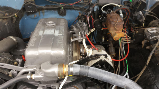

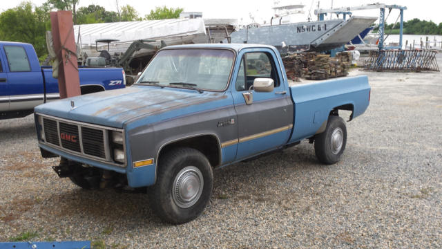

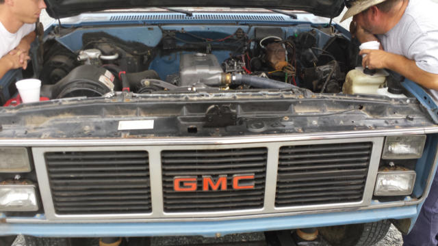

  18. chesapeake46
    chesapeake46 Senior Member
    Jul 26, 2009
    1,850
    My friend put a 4-53 into an 80's Chevy pick up truck for fun.
    It is a screamer. Maybe he'd sell it to you for a grocery getter....
  19. K1W1
    7,435
    Is it painted Army green and has a You Tube video of it?
    While I can't say I am not interested, LHD of an 80's vintage is not the easiest thing to get on the road at home. I already have a couple of vehicles that are restricted to short journeys at 20mph on the road between properties.
    If he does want to sell it PM me some contact info I know another guy at home who is a Blazer fanatic and has done a couple of major repowers and rebuilds. A visit to his place would make anyone think he was growing some more given the number dotted around. Last time I was there he was storing firewood in one.
  20. chesapeake46
    Jul 26, 2009
    1,850
    Not on YouTube, I don't believe.
    He would probably sell it. Last time I saw it, it was just sitting.
    He also did a 51 dodge power wagon, years ago, with a 3-53 ( i think ) and sold that to a local guy. You could hear him for miles.
    And speaking of Detroits, the landing craft in the background had a couple 6-71's in her.
