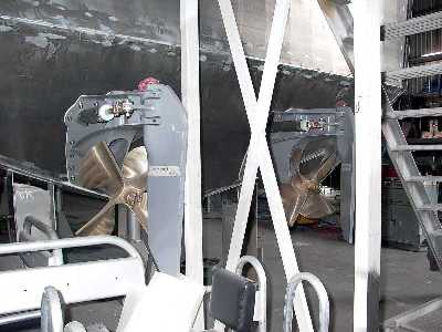

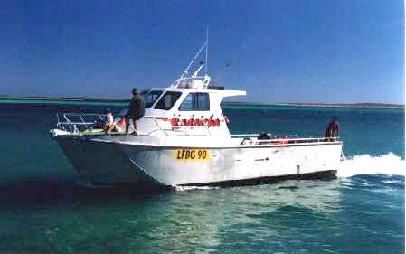

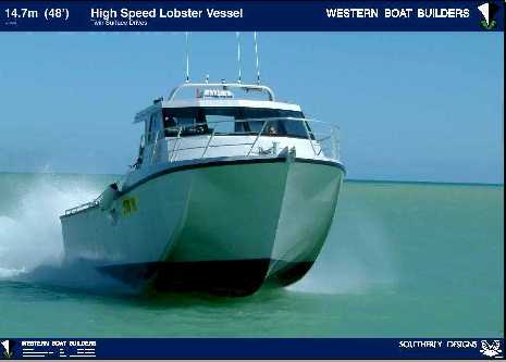

    Ohh - we can do pictures?
    Here goes then.
    First two photo's show Sea Fury during construction and in the water - last one shows aresson equipped vessel. (If this upoad thing worked!).

    Brilliance lies in simplicity! Overcome the obstacle and function is restored. Leave it to the boys from down under! The Aussies have made significant contributions to hull designs and propulsion systems over the years.
    This is an excellent example of combining a straight forward propulsion system to the right transom configuration. All too often, propulsion systems are developed to work on a variety of boats, but few boats possess the proper design to capitalize on certain drives.
    Harry Schoell's "Pulse Drive" addresses similar issues. Harry is easily one of the greatest minds in the marine industry, with a number of patents to his name. Harry's stock system is more of a bolt-on configuration, but many of the same design elements of the Pulse Drive are being adapted to larger vessels, where the hull shape is configured to accomodate the drive.
    Thanks for sharing Trouty! You're always informative! :)
