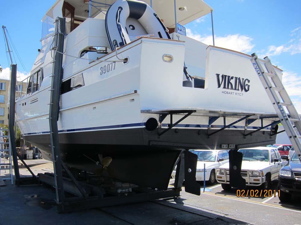

    We have no sling lift available, the only thing we have available is a mobile cradle. I have been unable to locate the correct US term for it (we call them slips in Oz) but essentially it is a full cradle on train wheels. It lowers into the water, you drive the boat on and pull the upright timbers up to the sides and lock. Then they winch you out of the water along train tracks. It stays on that cradle the whole time. Photo attached.
    This is fine with my current boat as the whole keel sits on timbers and the side uprights hold her there.

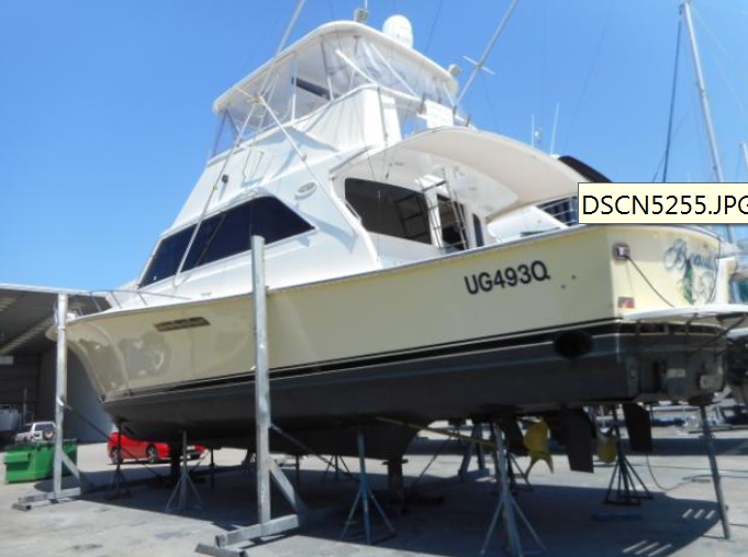

    On the Ocean, it appears to have a small keel that runs up to about midships and stops. Then nothing but running gear. I have attached a photo of one that was placed on stands by a sling lift, but I am sure you all know what it looks like.

    In the USA it's called a railway. It predates the travel lift and some older yards here still use them. Many wooden boat owners prefer the railway method over lifting with the straps of a travel lift.
    In any case the boat will rest on whatever keel is available. In the case of a deep vee or no keel, or if support is needed further aft they will block it up so the running gear will clear the railway cross beam.
    Full keel, short keel, or no keel is a non issue so long as the yard is competent.

    The yard should have some way to block the aft section at the chines. It appears that the keel on the Ocean carries back to where the engines are located therefore supporting most of the weight. As long as they chock it at the chines it shouldn't be a problem. The only thing that I would be concerned about is the length of the cradle that is being used. You would need to know the length to insure support for the rear chocks. My Dad has told me plenty of stories about his railway and I've seen pictures but, as far as using a rail it was way before my time.

    dsharp - thanks for the input. Correct, I have looked at the boat now and can confirm that is exactly where the keel finishes. I am thinking that the section aft of the keel must just hang in the air! The stringers are a good 450mm wide so i dont think the cockpit will fall off. (hoping.....) We might be able to put a timber prop under the cockpit area for additional support once it comes up out of the water.

    This is what I got from another member, it may provide some help. A friend of mine had a 38 Ocean and it was chocked at the very end of the keel and it cracked that area. I would put the last keel block forward of the end of the keel by 12 or so inches and would load the chines, see attached.

    The marine railway shown will load 100% of the weight on the keel. The side towers are only to prevent overturning. Trying to get load onto the chines on a marine railway is extremely difficult due to the slope of the railway. About the only way to do it safely is to build a trapezodial cradle so you lift the boat level despite the slope of the rail. Otherwise you can't support the chine until the boat is all the way on the railway cradle. Another option is to get the boat landed on the keel but not haul it all the way up so you maintain some bouyancy and then have divers install chine supports then haul the rest of the way up. However, this is risky if not done right or if the railway has any high/low spots during final haul-out.

    I believe you will find blocking instructions in the Ocean owners manual. They clearly spell out that you cannot support the entire weight of the boat on the keel and I believe recommend most of the weight be supported on the chines.

    Float on, block, then roll it up. As long as their motor can handle the weight and the frame can handle the size it's no problem. And keep in mind that most of the weight is below the motors. That's where your main keel blocking is. The rest of the blocking is mainly for stability and to keep the bottom supported so it doesn't warp. Personally I prefer the rail over the travel lift. One Google search of "Travel lift accidents" will show you why, plus more support and less swing. Unfortunately they're not practical for most yards today.
