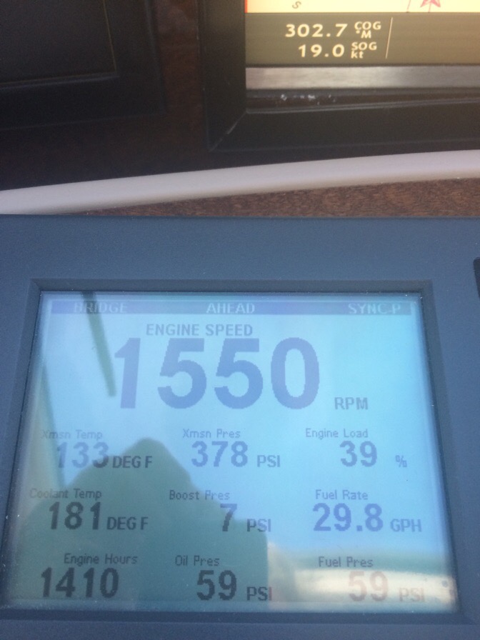

    We took her out today with the owner and I took this picture. 1550rpm 19kts on 39% load and 60 GPH combined Bow rise while accelerating measured at only 3 degrees.
