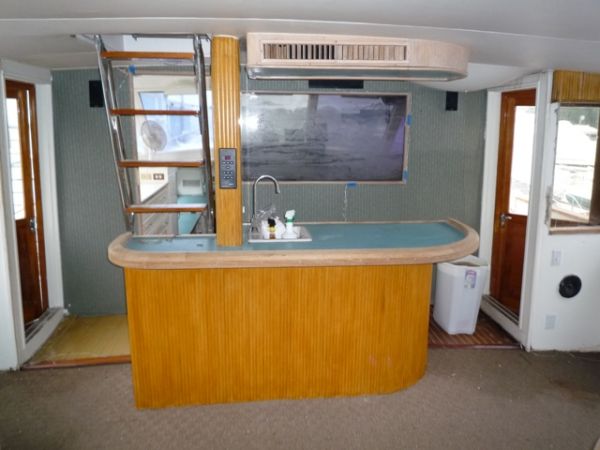

    Some misc. ramblings:
    1) For 74-foot boat, that thing's got an eensy, beensy lower salon. In your first pic, that (relatively) stubby cabin top almost makes it look like a Hatteras. A 60' Roamer I was thinking about buying a few years back had lines more reminiscent of the wooden Constellations and the larger FRP Commanders. This one looks kind of...I dunno...not Chris Crafty.
    2) The plywood deck means she had teak all the way forward, I believe. Was the plywood they put back marine grade? If so, you might be able to get away with cleaning the top surface with 36 grit and laying on a layer of 1708 or 1810 biaxial weave fiberglass. Run the FRP up onto the adjoining surfaces, then do some pretty fillets to smooth out the joint with the aluminum on the outer perimeter and the cabintop on the inner.
    3) Nothing in the upper salon pic is scary, but then that's the nature of pictures. Work zones are dirty and disorganized, but there's not much harm in that.
    4) Am I seeing aluminum I-beam frames covered with the deck plywood? If so, good, since that's lots better than wooden ones. But you've got to wonder why they didn't just use sheet aluminum decks like they did on certain other models of Roamer--like the 60 I was looking at. Any idea if they barrier coated the frames and plywood where they meet? I wonder what 4x8 sheets of 5052 aluminum plate is going for these days???
    5) Again, that's an eensy, beensy little galley for such a big boat.
    6) The dining area seems really narrow and I can't quite wrap my brain around the layout. But nothing looks too scary there, either.
    Detroit power is good, but don't trust the seller that they start and run until you see it for yourself (or--even better--hire a Detroit guru). Ditto for the gensets.
    I also would be interested to know what the bilge spaces looked like. And by that I mean all of them from stem to stern. That 60 I was on looked pretty good on the outside, but the framing looked like Swiss cheese from salt water attack in some areas.
    $30k is beyond nuts, though I wouldn't doubt that the seller is into it more than what he's asking. What it's worth right now today is scrap value at a commercial boat breaking yard. $5k cash might be fair if you're really sure you are a boatnut...I don't think it would sell for that on ebay.

    I too was surprised at the layout of this boat as I compared it to those roamers from 60' -68'. Main salon had circular staircase down to stateroom on port opposite toilet, further aft to master stateroom with toilet. Back up top main salon moving forward past helm down stairs into dining area, shelving & dishwasher to port opposite L shape couch. stair down to stateroom with toilet to port. to starboard galley. Through galley to crew stateroom and toilet. Main salon was small due to aft deck being so big, 5-6'. asking price is $20K. marina is trying help owner sell, because they realize they're going to probably get stuck with it. Marina does not have travel lift capabilities for the boat, but has made arrangements with neighboring marina. marina states that if they take over boat, the process takes 6 monthes, loses dock revenue, etc you get the story they are spinning.
