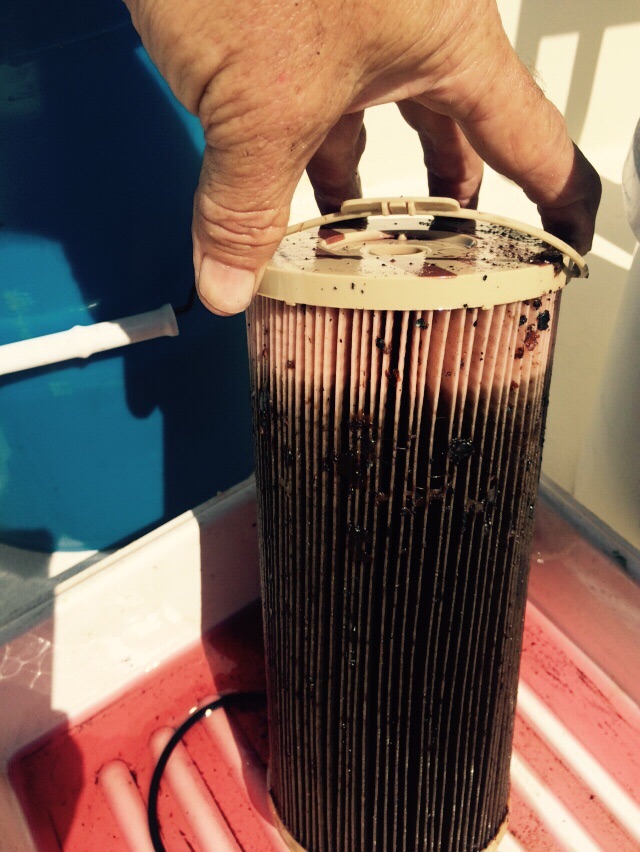

    Quick update on 6V92 Detriots, low rpms.
    Per Info from you guys.
    I pulled out the 2 micron Racor filters, the starboard filter was 3/4 discolored from ?, wasn't water as there was no water in sight bowl, and black fine strands of something, floating in filter fuel which I drained out to get the sediment out of the bowl, sediment in sightglass appeared to be, sand, dirt, debris of unknown origin.
    Black algae like organisms globbed on the outside of the filter element, a real witches brew.
    Cleaned out the mess and installed 2 new 30 micron elements.

    The engines sounded way happier, both settled into an even idle,(starboard had been idling at 670+-, port at 605+-) both now idle smoothly at 605 rpm.
    No more grey smoke and without a lot of trim tab tuning both were turning about 2290 rpm.
    Next step is to paint the bottom, and keep running the old fuel out and keep an eye on the filters.

  16. Capt J
    14,435
    If you've got that mess, clean the racors out completely. Buy new gasket sets for them. The bowl comes down with 4 3/8" (headed) bolts, unscrew the turbine and the ball and gasket come out and entirely clean the turbine out housing etc.....

    did you notice a change in the vacuum gauges?

    image.jpg image.jpg Here is a photo of a dirty filter.
