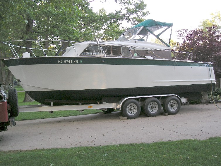

    Help!
    One of my 283's spun 2 rod bearings which looks like for the second time basesd on the 2 cylinder sleeves. My question is has anyone mated up the chris craft mounts engine, paragon transmission, oil pan, etc. to a more modern small block 305, 350 etc that has a stronger lower end and will the paragon trans take the extra power?
