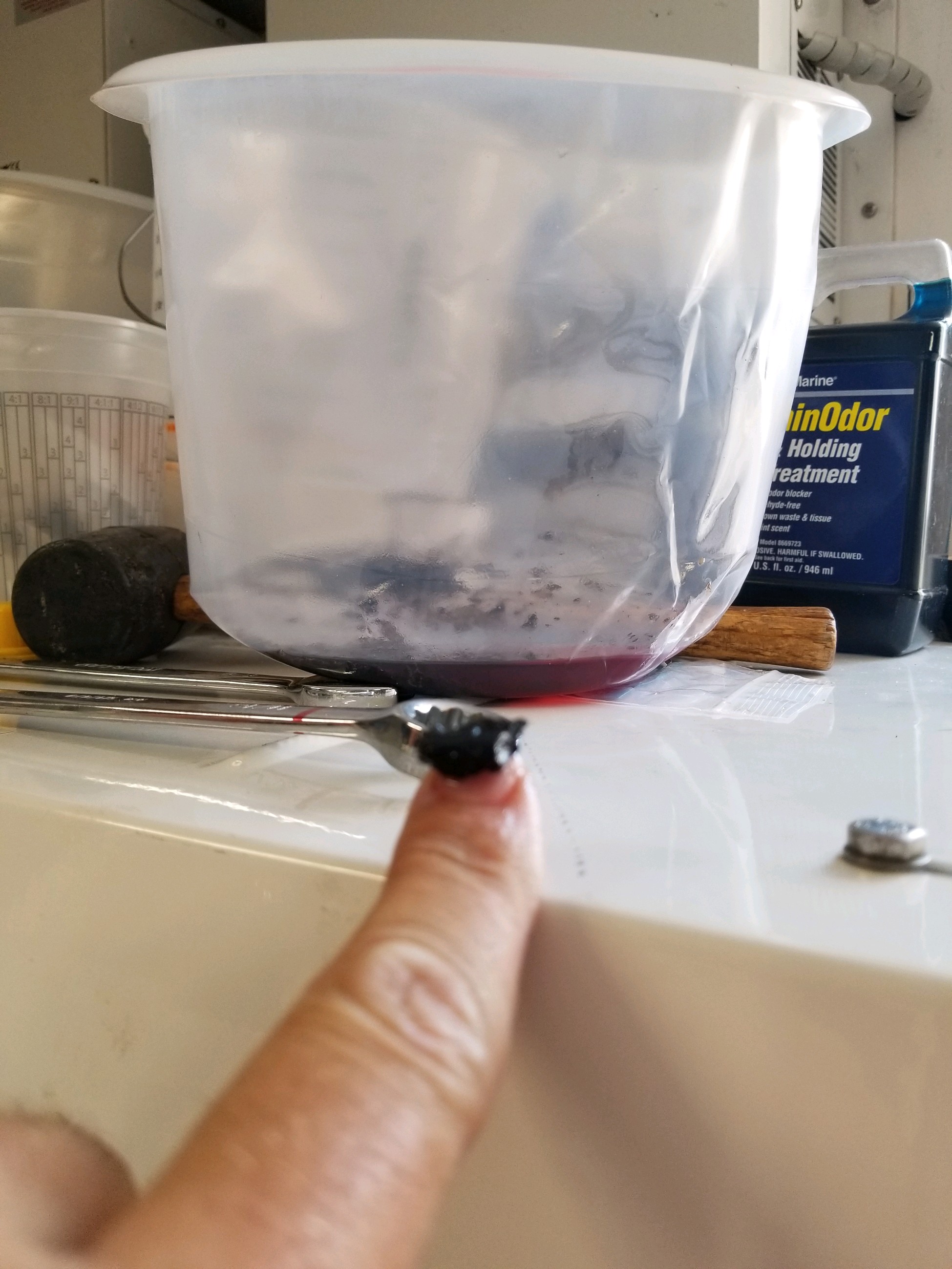

    Anyone ever seen this in bottom of racors?

    Yep, dead bug poop.
    Any body recently added any biocide or change fuel suppliers?

    No. Just found a ton of large soft rubber chunks. Trying to upload
  11. Capt J
    14,435
    Fuel hose is collapsing and it’s the interior of the fuel line. You have a tank vent issue and fuel supply lines need replacing
  12. Capt Ralph
    12,753
    Thought good ole Vikings use copper lines. Could be just a few feet of hose here & there to replace.
    Now, Tank inter-connect hoses could be fun.
    I did have a fill hose start to fall apart on the inside a few years ago.
    If it is rubber, a lil at a time..
    Your Racors should catch it fine.
