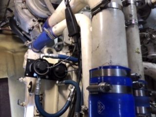

    System installed and running, I spent $2800 with all components, hoses and nema 2k cables and so far impressive running off my Garmin 7212’s. The system sees 1.3 to 1.5 gallons per hour At idle and increases higher as tested ran at dock so far. Overall, it was an easy install...just lengthy because of the preparations needed for where to locate the devices, how to route hoses and running the cabling for the systems. 47D6F7CA-E237-4BFC-9EE4-6522C0497CC8.jpeg

    They work great, once they were set up I've not had any issues. Customer service at Maretron was awesome!

    No issues at WOT...the orifice of the JIC connectors lines used on the return side was similar to the stock discharge elbow with the restriction.
    The Maretron parts I used was 2 m2ar flow sensors with fm100 monitor per engine and used j2k200 gateway to program it all with their techs help.
