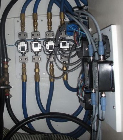

  3. My Affair
    My Affair Member
    May 23, 2006
    116
    Mystic, CT
    The larger ports I see are for much larger minimum flow, well above the level . If the unit is rated to flow up to 132 GPH how will the smaller port impede the operation- what am I missing? While I realize the hoses and a lot of the fittings are larger on the supply & return lines, however when you look at the actual orifices that some of the hose and fittings use to connect from the secondary filter to the engine, then from the engine to the fuel cooler those fittings appear to be small- maybe not 1/4" but still small.

    OK, I wonder if the fuel pump on a 6-71 has enough pressure to push the flow I need to reach WOT going through that device. The flow reached on their website may be using an electric pump or one of higher capacity. I've now gone as far to ask technical support- what if after they are installed on my engines and I cannot make WOT after the install what will they do to support me. The fact that they cannot give me one example of these devices in an Detroit Diesel 6-71TIB installation is a cause for concern

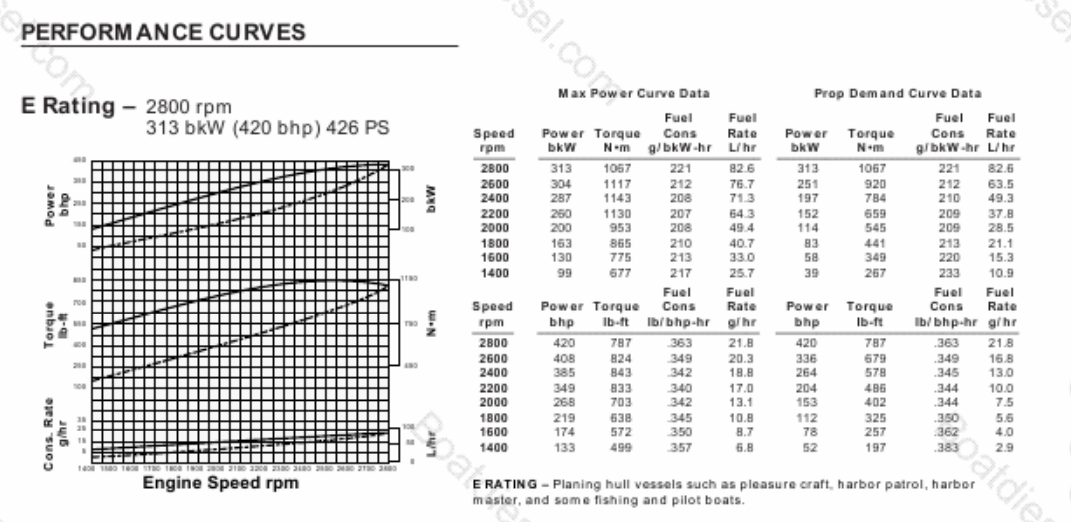

    attached is a photo of an install of Cat 3126- appears to have a higher fuel rate usage than my 6-71's?

    Again, these are fuel consumption curves, NOT the thru flow of fuel in a Detroit.
    Lots of fuel is returned to the tank from a Detroit. Usually by way of a fuel cooler.
    Sadly, I can not quote the numbers.
    I have witnessed a broken hose after the restrictor on a 12V71TA at fast idle on the ICW; 1/2" hose and I could of sprayed down the bilges like a hot water hose,, as it was trying to do already.
    Not a pretty day but good example.
    I'm not a Cat heavy but I don't think they return a lot of fuel.. Somebody help me here.

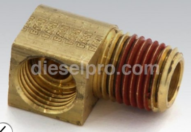

    Also, I wanted to note the inverted flare fuel restriction orifice head inside the elbow fuel inlet is 1/4 x 5/16 NTP. This is the elbow that connects the fuel hose from the secondary filter to the engine. I found this example on Diesel pro.

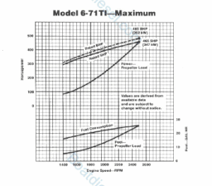

    A 12v71TI will return around 100 GPH at 1000 rpms.
    Why is it so hard to just print out the fuel curve graph and calculate your fuel burn on any engine? I never have any issues keeping track of fuel burn on any boat I run and don't need a magic device to do it for me.

    My factory fuel chart is pretty close and refer to it when I need some real depression.
