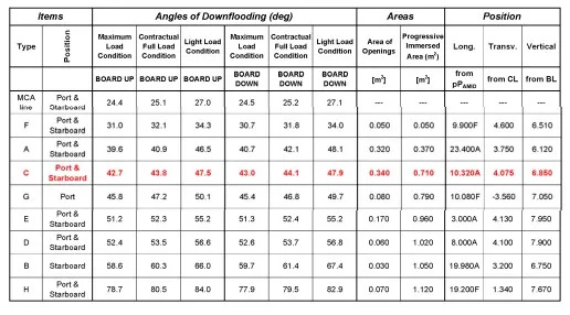

  14. BlueNomad
    BlueNomad Senior Member
    Jan 11, 2022
    108
    At Sea
    That certainly appears to be the most likely scenario.
    The stability info clearly indicates that this vessel was never intended to be heeled to 40°+ and included a bespoke load monitoring system during sailing operations to ensure that never happened. The calcs do not show any assessment of wind heeling moments, at rest or under way, upon the vessel in a board up condition.
    "If you can't house your mast, you can't house your keel."
    -Traditional wisdom

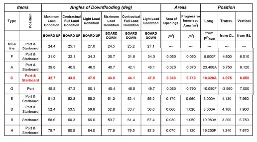

  15. BlueNomad
    Jan 11, 2022
    108
    At Sea
    Taken from the stability booklet, this table shows downflooding actually begins around 30° with the board up. The opening is a 'small' opening forward, with a cross-sectional area of 500cm^2.
    This opening was not determined to be critical due to its size and possibility of progressive downflooding. However, it's highly likely that any volume of water taken in through this opening would result in a reduction of the calculated righting characteristics, leading to greater heel angles being reached more quickly than anticipated.
  16. kevin8tor
    kevin8tor Senior Member
    Jun 6, 2007
    24
    Northern Chesapeake Bay
    I mentioned this same theory here almost 3 weeks ago and was largely dismissed (post #130). Glad to see it's being revisited as a potential and significant contribution to the rapid sinking.
    These salon doors exit to the sunken cockpit/entertainment area that extends all the way to the side decks of the yacht. If the boat laid over on it's starboard side, this would allow this cockpit and potentially the salon to be inundated in short order.
    All speculation, indeed, but food for thought. Apparently, the boat will be raised at the expense of the owner, according to the same video.
