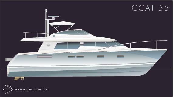

    Together with a fellow-member at the Forums, I have made some proposals for a GRP powercat in a size where we think a catamaran is big enough to make use of the internal hull space, still small enough to fit into the marinas.
    The first idea was to use the current trend among sail-cats, with straight bows and avantgarde superstructure. Second thought gave that it might be too much new ground to break, so today the concept is more like a cabin-cruiser people can relate to.

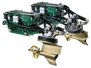

    At 55 feet the beam will be about 22 feet and powered with the new Volvo-Penta IPS/500:s she will have a sweet cruising speed of 25 knots and up to at least 35 knots top speed. The IPS drives will also reduce the draft.
    Before we go any further, it would be nice to hear from the YachtForums members if you think this is an attractive concept and if the styling is what you would like to see on such a boat? Any and all comments are welcome! :)

    She certainly looks nice, the newly designed Volvo engine is placed midship, so that saves a 2nd engine and gives a more efficient engine configuration. I wonder if you can get the prop deep enough to avoid dry running in following seas.
    Most probably she will sink in a bit more when she is loaded.
    Have you already made your weight calculations? About 10/12 tons displacement unloaded?
    Looks good,
    Brien

    Hi Brien, yes she is a Cat I would like to have myself.:)
    But she actually should have twin engines, which btw is the only option to buy them today. But the nice thing as compared to any other engine, you will have the engines mounted horisontal while the drive is leaning to the center of the boat to operate in pretty undisturbed water. The hulls are symmetrical and with progressive V-shape. The draft on cats I am not used to calculate so she might sit a little deeper with these engines. Total weight is too early to estimate, but she will be built with PVC-foam cored vinylester and lightweight interior to achieve the desired speed and fuel economy.
    I think the forward mounted props at cruising speed will not cavitate from following seas, but I am glad you are pointing at such things.

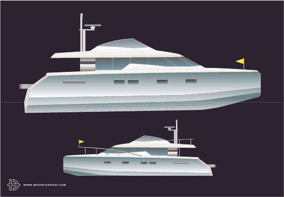

    Didn't we see this style in 1950? How about something more dramatic, I mean if we are going to start turning the engines around how about the whole superstructure..then we could drive from the bow! That would be really entertaining, at least for the one not holding the drink! :)

    Not exactly going backwards, but this early drawing might be what you are asking for? This is one of the most interesting issues with powercats, will people buy more extreme designs or do they want them to look as traditional boats, except for the twin hulls?

    No, the last design is no improvement. Clients looking for a powercat are looking for comfort, a fast and economic ride but no extreme designs. At least, in my opinion.
    Do you have more than this profile? I am curious how you placed the engines, I thought to see only one pod instead of two. Do you have interiors as well?

    The engines should be mounted as they are intended (see picture) on a V-bottom hull, but facing each other instead of pointing outwards. Must be even better!

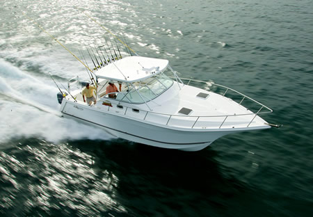

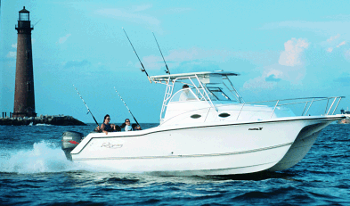

    My brother just bought this Cat with a pair of diesels. (the only one ProKat has produced so far). This boat has become fairly popular along the intracoastal in South Florida, as I'm beginning to see more of them on a regular basis. I really think they are onto something by connecting the sponsons with a V-shaped, mono-hull like deck. This not only offers increased deck space and provides a good bow-pulpit for anchors, but they are aesthetically more attractive and it appears more buyers can "relate" to them.
    The pictures below are for reference purposes from ProKat's website. The overhead view shows the increase in forward deck space, while the side view shows the anchor pulpit.
    This is a design that another manufacturer has adapted too. I'm certain that others will follow. Personally, I think this feature should be given strong consideration on your 55' PowerCat.

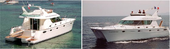

    The January issue of the French magazine Neptune is focused on powercats and most of them are without this fore deck. Only the Catana Legend, a 45-footer has it, but not going so far forward as on your pictures. There is also an interesting Vaton designed 80-footer to be launched any day, sporting some "Wally-lines" with a large seating area on the fore deck. I´ll see if I can find a picture somewhere...
