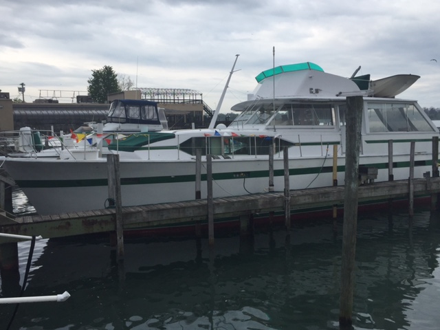

    So we just purchased our 55' Roamer we were planning on taking the trip from Buffalo to Cleveland today.
    The broker insists the boat should run at 18-20Knots, which would make the trip about 10 hours.
    BUT, the previous owner says he consistently runs the ship at 10Knots making the trip 20 hours. The owner says the ship will go that fast but burns through the fuel.
    The broker specializes in Chris Craft Yachts says he moved the sister ship a few years back and easily ran at 20Kn.
    The ship has dual 8V71Turbo charged engines.
    I'm very new to a ship this size. Would I be pushing the engines hard running at 18-20Kn? Was the previous owner just babying the ship for the past 20 years?
    Any help from the community would be welcome.
    Thank You
    -Captain James
