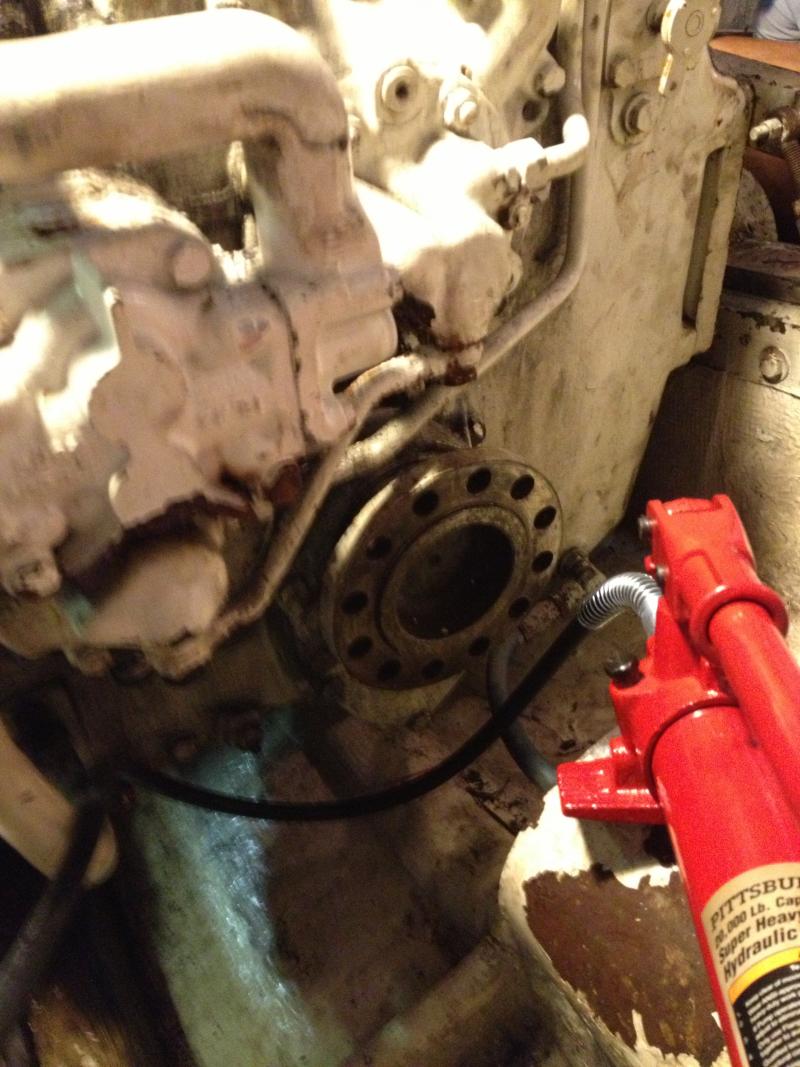

    Outstanding pictures. Glad things are working your way.
    My 12v71 / TD 514 gear slid straight back (on made-up wood rails) so I could remove the flywheel and replace the rear oil seal. Long threaded rod pulled the gear back into place (slowly). Been 7 years now and it's still pulling strong.
    ,rc

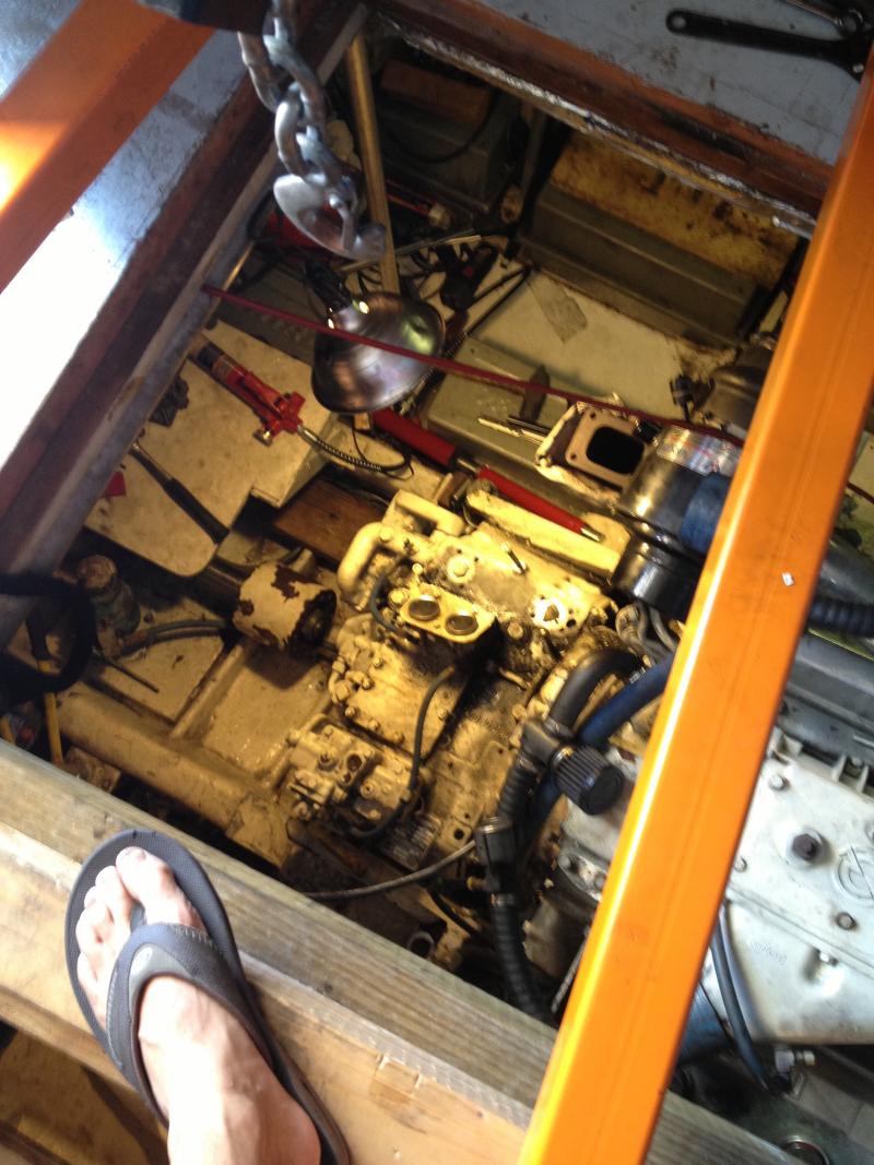

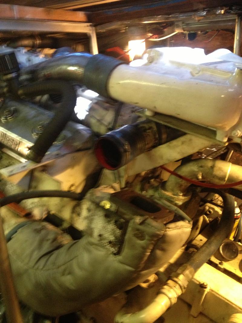

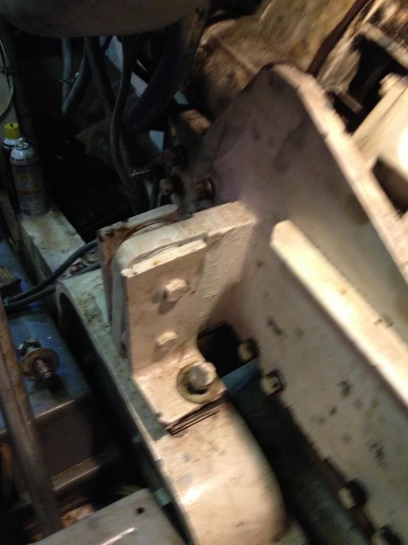

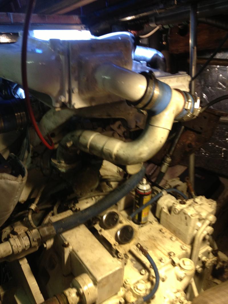

    We put in a full day today. We slapped on the tranny, aligned the engine to the coupler, put on the air boxes, Turbos and exhaust. It wasn't easy but everything looks good. Turned her on a little while ago and she started up within 1 second of given here fuel and starter motor. All pressures and temps looked good. We didn't run her because it was already dark, but Im sure she is fine.
    I think the culprit was definitely that 6 inch rope we caught 4 years ago in the Abacos..
    Thanks again for everyone's input. Will post a few more pictures..

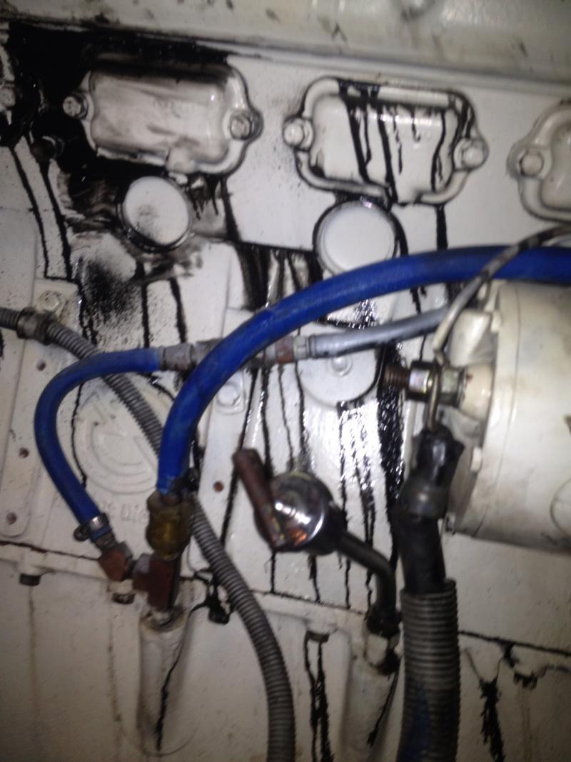

    I did have some oil leak out of the cylinder site windows. When I removed them to see the pistons all went up and down, I probably did not seat them right, or tightend them right. I have order a new set for that side.

    Of interest, When you peeked at your pistons, did you get any quality viewing of the liners and rings? How they look?
    I have learned the hard way, those old gaskets will leak when re-used. There is 20+ psi on those air boxes and any micro leak of slobber will find it's way out. New gaskets with just a wipe of grease on clean surface areas will fix ya rite up. Common gaskets, any good D/D shop should have them on hand.
    ,rc
