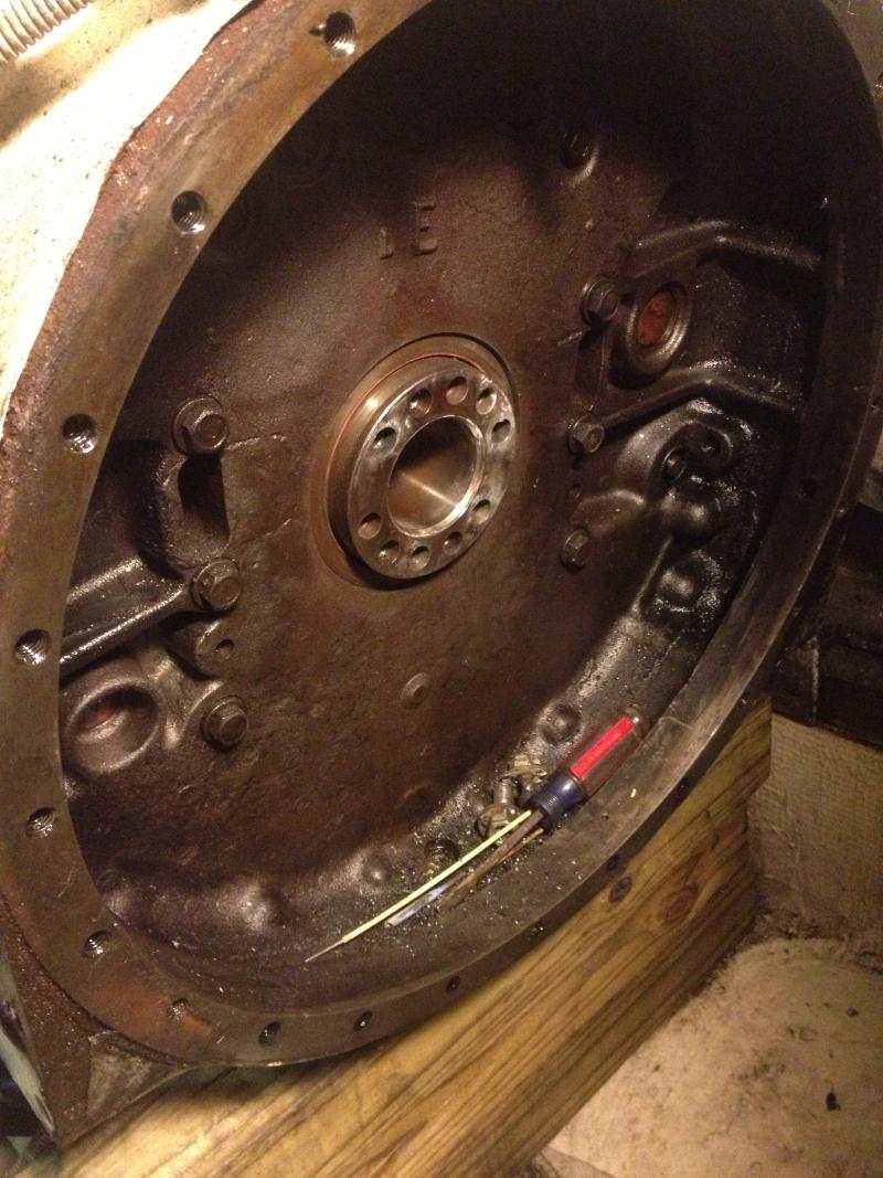

    Getting back to whats important. From the looks of the bolts it doesn't seem like they were all sheared because some broke well inside the Camshaft threads. Was this do to improper installation? I read today that you must use copaslip, the original never seaze. I wonder if they were installed without that, there was certainly no size of it when we removed the bolts.

    The two that broke last 1st from left and 3rd from left look like they have broken in the area I would expect for a bolt that had been stretched or over torqued.
    I would suggest that it would be prudent to get a Tap Wrench (Plug Type for use in blind holes) that suits the thread and run it through the holes in the crankshaft boss by hand to make sure they are all clean and burr free.
    You should be able to wind the bolts in all the way by hand before you start.
    Use Copper Slip as recommended in the manual, many manufacturers recommend similar practices.
    A lubricated thread is far more likely to enable you to reach the full torque, it is the tension under the flange of the bolt head where it contacts the flywheel face that provides the resistance to turning.
    If the holes in the flywheel have been welded and re drilled make sure they are smooth and the mating faces level on both sides.

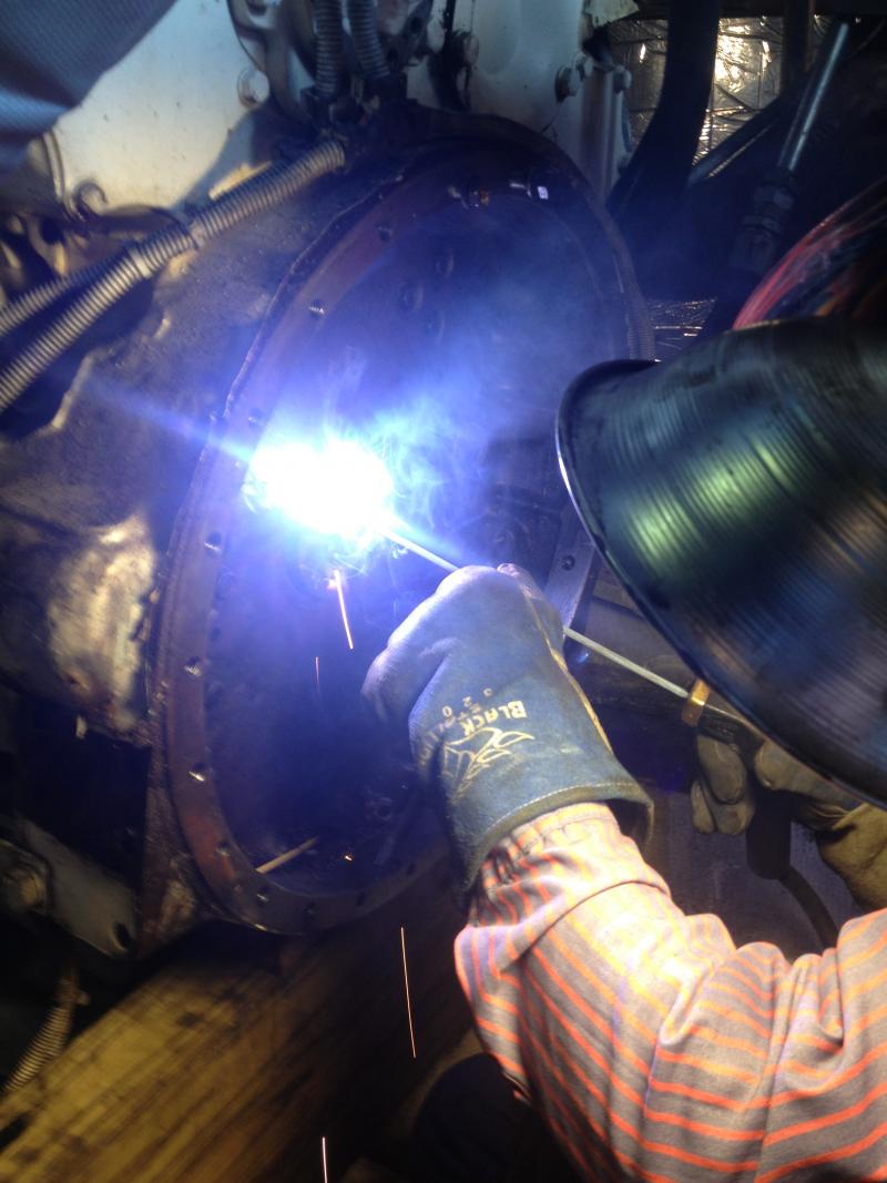

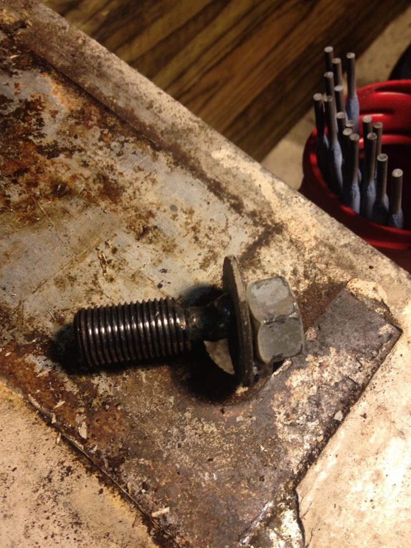

    Today a machinist is coming out to remove the other broken bolts. He recommends welding a piece of stock to each one and then welding on a bolt head to turn them out.
    Then we will replace the crankseal and put on the fly wheel.

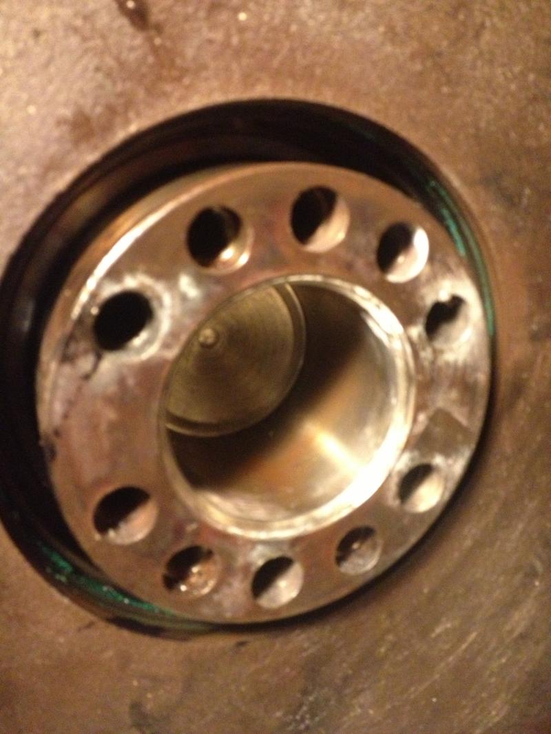

    Anyways, looks like we have some work to do with the crank and cleaning it up. Threads and all, before we set the new bolts in due to arrive tomorrow.

    Be carefull,the mating surface between crank flange and flywheel is close tolerance, if any galling is present on either surface expect failure even if you replace all the bolts. Keffer

    Greg and I on the other had proceeded with the issue at hand. We were able to reattached the flywheel to the crank properly with new rear crank seal to boot. Then came the moment of truth. I spun the engine with ease with fuel rack off. And then, just a couple of turn with fuel and fire and all of sudden there was exhaust fumes everywhere. There seem to be absolutely nothing wrong with the motor.

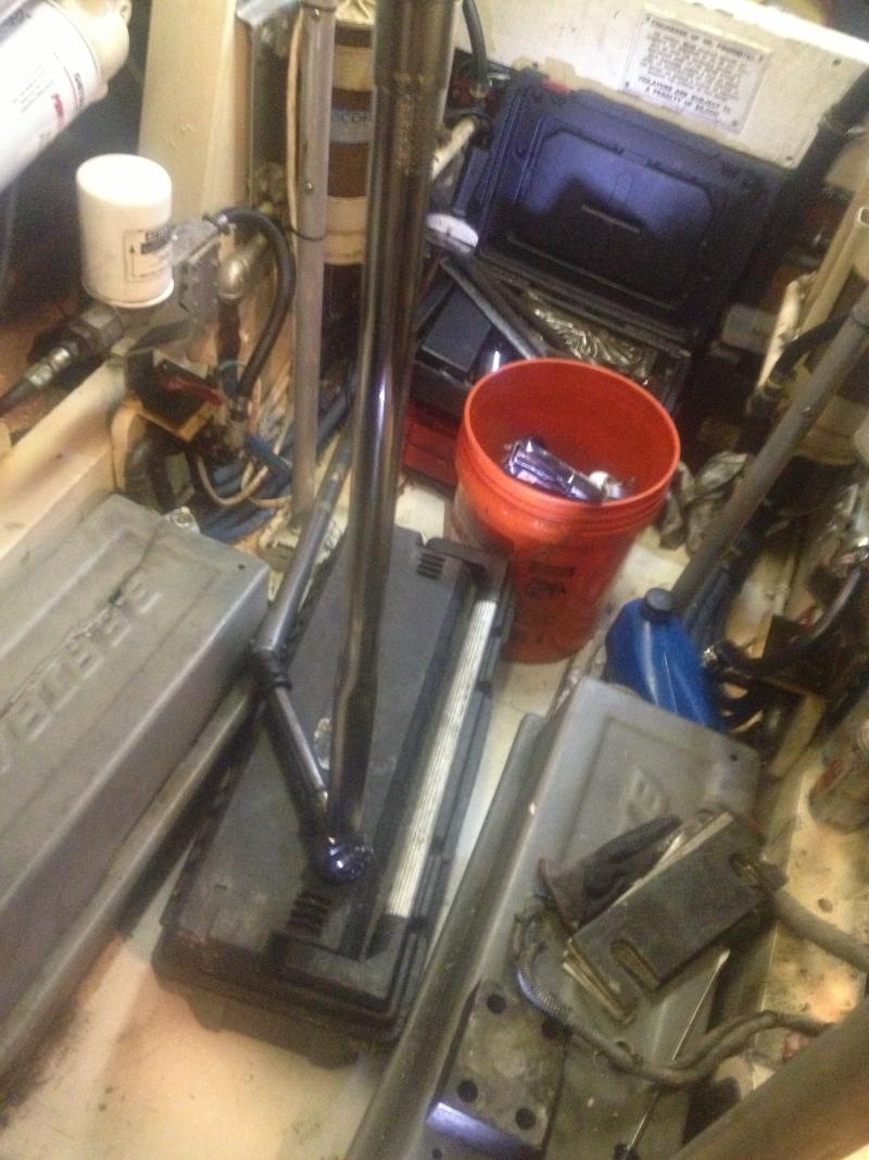

  19. CaptOz
    CaptOz Member
    Apr 13, 2009
    100
    Miami, Fl

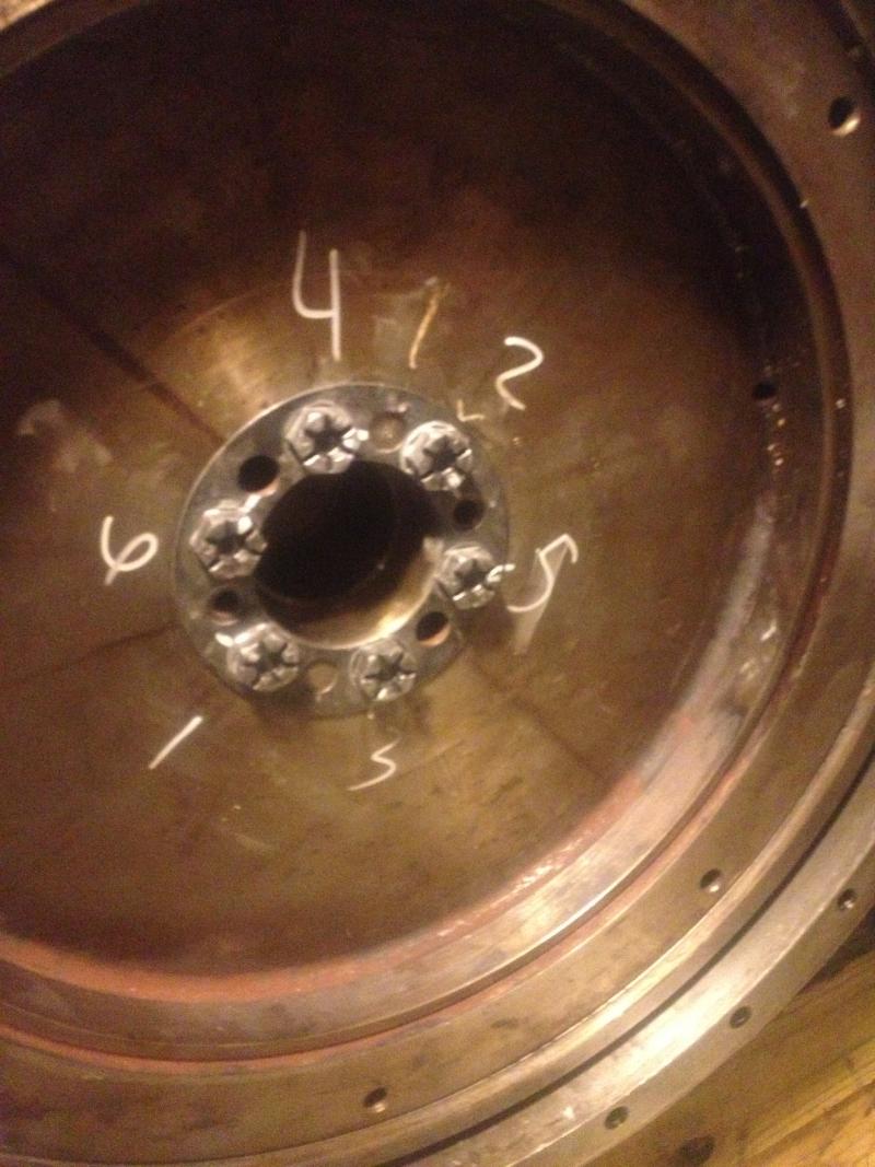

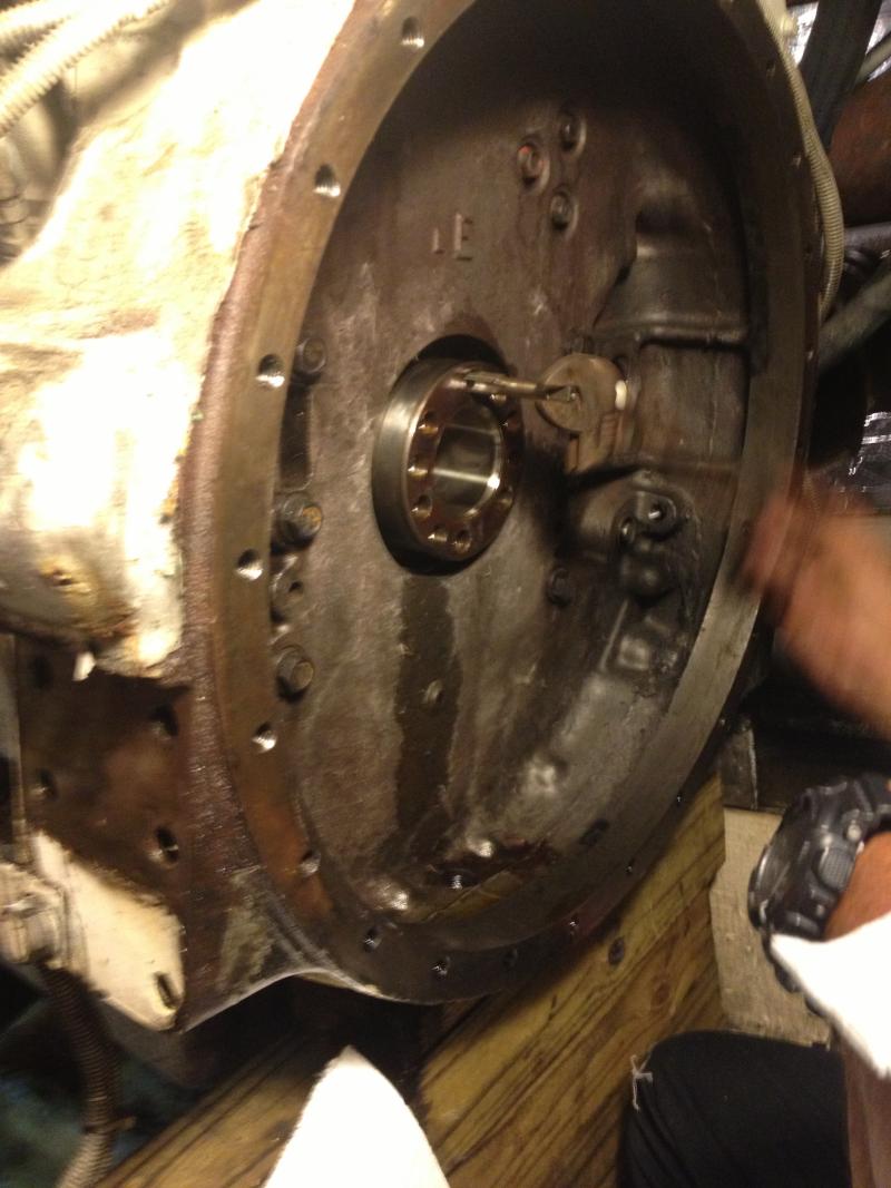

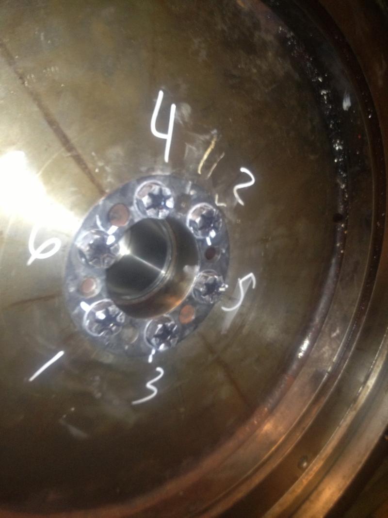

    Here are some pics..
    For the record we torqued the flywheel bolts to about 50lbs with torque wrench then we marked off 90 degrees on each bolt and attempted to torque to that angle. We had to break out the 3/4 inch torque bar for this job. The readings went well above the 184 in the spec. It was more like 220. However we only went 90 degrees not the max mentioned in the manual which is 120.
