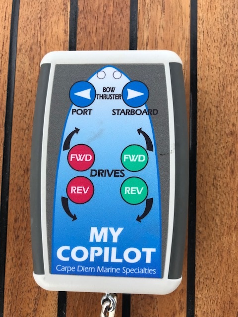

    No need for the stern thruster now, I was able to adapt a wireless remote control system that I developed for the Cummins powered Sea Rays to work with the Volvo TMAD74s that use ECMs to control the throttle and drives. Now I can be anywhere on the deck as I maneuver the last few yards to the dock and grab a cleat from the boarding platform then use the thruster to hold the bow on the dock while I secure a bow or mid ship spring line.
    It really adds a layer of confidence operating the boat since my wife is very intimidated with line handling on the larger boat.

    Hi i would love one of your units ... i have a 1998 Carver 530 with Cummins engines.. will your system work with my boat..Paul
  7. Rusty Mayes
    Rusty Mayes Member
    Sep 5, 2019
    56
    Sanfransico Bay area
    Paul, It depends on how your drives are controlled. If they are electrically controlled with solenoids then my system will work. Most of the systems I build go on mid to late 2000s cummins powered 40 foot plus Sea Ray fly bridge boats. PM me to discuss the application further. I can accommodate bow and stern thruster installations.
