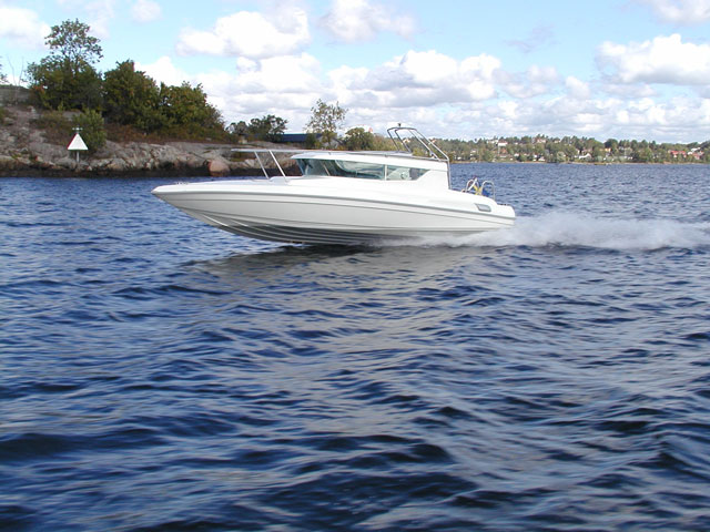

    This windscreen that we have on all three models we produce at present, has no significant negative effect. A normal slooping windscreen is creating more downforce which gives a larger wetted surface and a slower boat. Our windscreens might have a lifting effect instead, but with increased air resistance. And air is softer than water after all.
    With eight lifting strakes on the 26° deep V-hull, this boat is riding high and has very little spray and wake. Here at normal cruising speed just under 40 knots.

    This, I can relate to
    Aah, yes, the chines of freedom. Looks exactly like the water in Greers Ferry Lake, on a perfect day to slalom. She sits up and rides nicely. And, (in hindsight) that's what I meant, because the cabin clearly sits back of center, so it surely "lifts," and if anything just to help the chines do their magic, (at this speed.)
