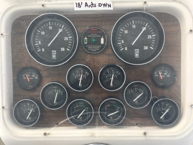

    ABE878B6-9809-4F53-A0DA-879C0C1EF8A3.jpeg Here is a photo of the gauges this past weekend this photo was taken with approximately two hours time on them add 2000 or so RPM everything was stationary sea water temperature 48°.
    Starboard voltmeter gauge is broken ignore that please!
