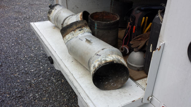

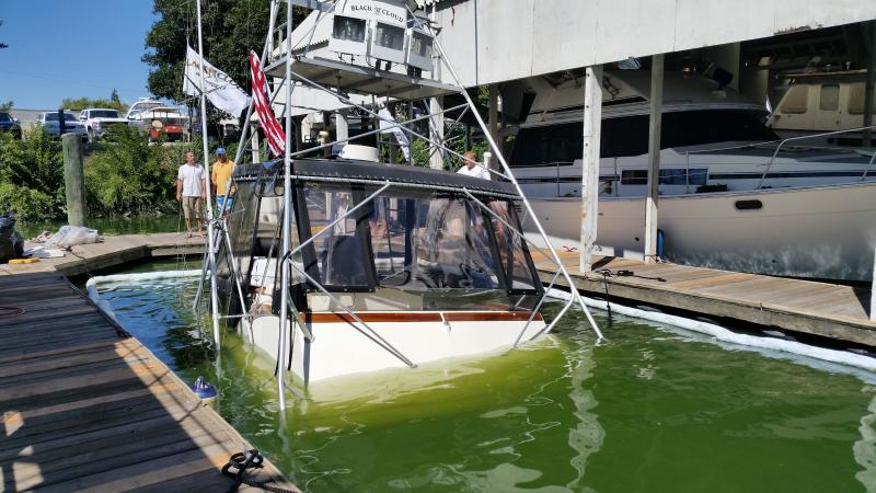

    Hi all, Last week at the shop a Post went down a few days after launch. It went down in less than 2 minutes. The cause was that the port muffler exploded. The hole was 2 as large as the outlet through the transom 8".
    The owner stats they were getting ready for sea trial. The generator was running, they started the port engine (DDA 6-71TA) within in seconds they heard a loud bang, saw smoke. The boat started down immediately, they got everbody off.
    My thought is since the exhaust goes through the transom at 8", the muffler is approx. 24" long by 24" diameter. Maybe the muffler was full of water and when the started, the pressure created to push the water out the 8" hole was too great and the muffler gave way. Only problem with this thought is that a lot of boats are rigged this way and don't sink. Any thoughts?

    9114 S. Central Ave
    I'd like to see a diagram of the exhaust system showing diameters, height above water line, and a photo of the failure point.

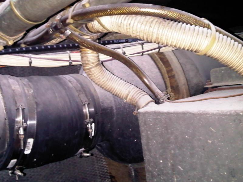

  4. P46-Curaçao
    P46-Curaçao Senior Member
    Mar 8, 2013
    734
    Not a great picture, but it shows the muffler...

    Post # 4 is exactly what it looks like. I'll try and get some dimensions tomorrow, but I can tell at least a 1/3 of it is blown out. Whats odd is they had ran the engines a few times earlier in the week. They got the boat up and out of the water. We pickled both engines and gears. Both engine lit right off, so I think that much is salvaged. The interior is destroyed oil everywhere. The only saving grace is that it went down in fresh water and here in CA it is very dry, low humidity.

    I remember seeing Black Cloud at Avalon a few times, sad to see here go down. We purchased a 46 Post sistership out of San Fran quite a few years ago, not too many of them running out west.
    Very few production boats are capable of blown exhaust openings of 8" plus, takes some very quick thinking too stuff life jackets or whatever to stop the sinking.

    If it's like my 46, the exhaust is 8 inch and sits about 1/2 to 2/3's submerged all the time.
    The original exhaust tube does not pass to far into the bilge from the transom.
    Then there is exhaust hose to the muffler. Then hose from the muffler to a metal offset tube. ( in my case it was an 8 inch aluminum offset ) then hose again but now elevated by way of the offset tube, up to the exhaust mixing elbow.
    The muffler is not elevated, but is on the same center line as the exhaust tube at the transom if that makes sense. I want to say "level" but nothing ever seems level in a boat.

    There is a 1/3 of the muffler missing from the side of the muffler. The pieces were in the lazz bilge after it got raised and pumped out.

    Wow, that's a big piece of the muffler. Any analysis of the cause yet?
