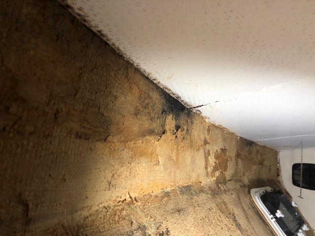

    this is one picture of the worst damage spot
      67.4 KB

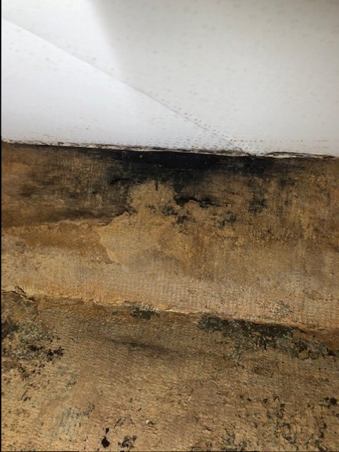

    this is the board in the hull I spoke about replacing
      65.4 KB
      626
  10. cleanslate
    cleanslate Senior Member
    May 29, 2018
    1,658
    Cherry Hill, NJ
    That board is plywood....which is all over the inside of your hull from the looks of it. A lot of the wood still looks ok. You have to stop the leaks first.
    Not sure if it need replacing.
