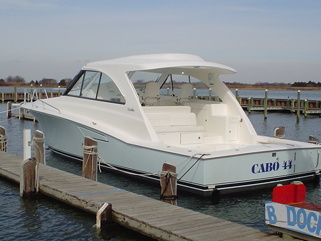

    Cabo 44HTX 010.JPG What about this guy

    I believe that newer style with integrated hardtop 44 would have been transported finished as you see in pic. That is a sweet boat. Perhaps MBY will chime in.

    Yes, the 44' HTX was shipped as shown in the picture in post #3. They were shipped all of the way from CA to FL without any issues. The 52' express/Fb could NOT be shipped into FL so those were shipped to GA, made water ready and then run to Ft. Lauderdale for Pipewelders to do the tower or hard top. Props would be off of the boat, but shafts installed. The majority of Cabo's went to Ft. Laud to Pipewelders/Hi-Seas/P+R Canvas and then either went to dealers from NE to Texas, or worldwide on ships once tower/riggers/electronics/enclosure done that was until they were moved to New Bern factory in 2012.
