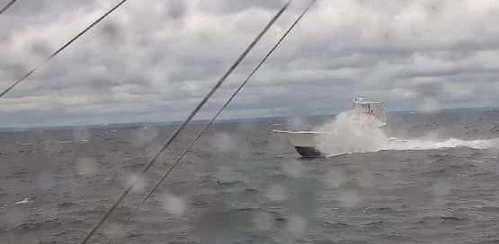

    I have had my 43 for two seasons now. I’m very much a fair weather boater. Still trying to learn the boat. Two trips come to mind. First was a trip back west from MTK to Glen Cove in the Long Island sound late October. Wind against tide, running into 2' to 3's with some 3' to 4's mixed in at certain points along the way. 3 to 5 sec dwell. First time running the boat in those conditions. Was pretty sloppy, had to keep speed at least 18 to 20 knots to keep bow up with no tabs. Still a bit lumpy. 20knts of wind so spray going over the bridge. Not a pleasant ride for 5 hours. Boat felt solid, not a whole lot of shutter. Pic of my buddy running a 43 post next to me that day.
