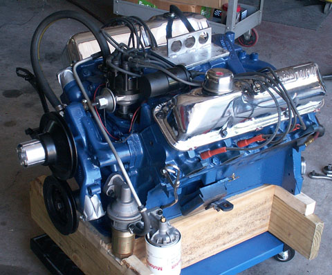

    Hello fellow roamer friends I have a 1966 37' roamer with 427 side oliers,
    and my port engine has oil comming out of the fill cap when I'm above 2200 rpms. I'm told that called blow by. Over the winter the engine was rebuilt and has compressen of 170 in all cylinders. What should I look for to solve this problem? Thanks Gravy

    Ford 427s have an exhaust crossover that runs through the intake manifold from the front exhaust port on one bank to the rearmost exhaust port on the other bank. The crossover rots out at a thin spot on the underside, which puts exhaust directly into the crankcase. You don't notice it so much at low RPM, but as you open the throttles the volume of exhaust pressurizing the crankcase overwhelms the PCV system and starts blowing oil mist and exhaust out the breather (and everywhere else it can find a way out).
    The fix for this requires pulling the intake manifold. There is no other way. You either replace the manifold with a new aluminum one (they're available online, just be sure to get the "non-EGR" version that doesn't have a crossover.
    Alternatively, get some thin stainless steel stock and trim it so it just fills the crossover port hole in the intake manifold gasket, thereby blocking off the crossover port. I've heard that SS butter knives are the perfect thickness.
    Oh, and change your oil. You've got a lot of byproducts of combustion going through the engine.

    Well I've pulled the moter and started to break her down and found that the chamber did rotout on the intake manifold and I would like to replace it with a used one that is a cast one for my 1965 427 ford side oiler. so if anyone has one or knows where one is please let me know. Thanks Gravy
