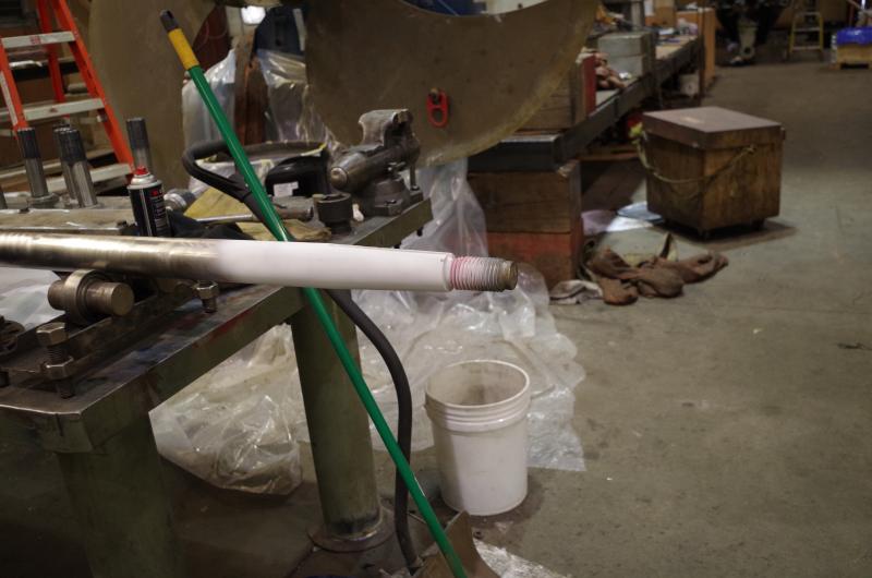

    So lots of good info here. I am in the ship repair business and have ben for a long time. Shafts are an area of constant concern for our customers given the scenario in a failure. The posts about checking alignment and the fit between prop and shaft are spot on and not to be taken for granted. My previous boat was a Sea Ray 390 and I also experienced an unexplained shaft failure. I do not attribute this to S/R as it can happen to any boat. The reality is that these shafts are under tremendous strain. Items can contact the prop without you ever knowing it. There can be suttle vibrations that go undetected. And yes, shaft material can have flaws in them that do not manifest themselves until years later and exacerbated by the aforementioned issues.
    The best way to prevent unexpected failure is to check the running gear even if you are not aware of a problem. Check alignment, inspect cutlass bearings, do a blue fit on the props each time you pull them and I recommend a simple Non Destructive Test (NDT) of the shafts using dye penetrant and developer to look for signs of cracks or inclusions. This should be done especially where the shaft begins it's taper (weakest point) and around the key way. Here's a few pictures of my shafts being NDT'd.
