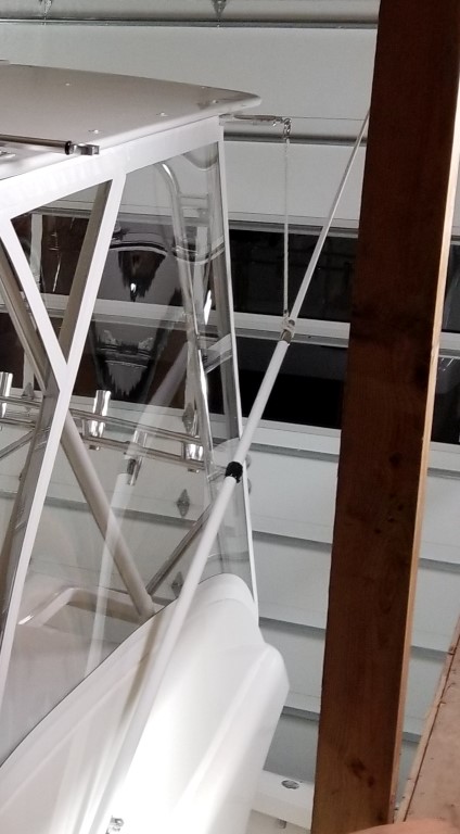

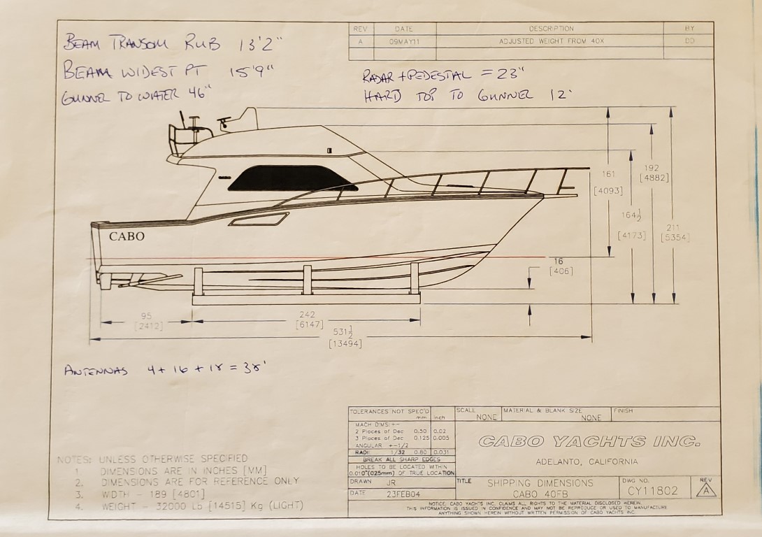

    When Cabo built the 40 FB they left California for the East Coast with no hard top. Local dealer would work with owner in designing hard top and outfitting boat. Further more the bridge itself was installed at the dealer during commissioning. If you look closely at how the main house and bridge are secured it is possible with a lot of work to remove but I would not advise to do so. I did this to a previous boat and considered it with the Cabo until I saw how well they secured the two parts and decided it was not prudent to attempt. I guess what I am saying is while possible to make a 40 road ready I wouldn't advise after being fully rigged. I would ship or run on it's own bottom. I have attached the sheet I put together at time of purchase to prepare for shipping. If you remove the outriggers you can use the standoffs to secure your antennas in down position and easily get the boat under 17ft total height from waterline.
