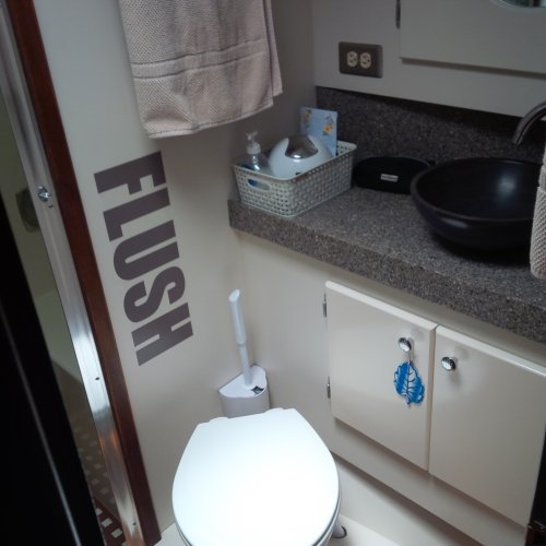

    Yes, I templated it myself, bought the Corian sheets at a local store, but the work has been done by local (cheap) craftsmen.
    After I see them doing it, I discovered that it was a pretty easy and strait forward job, just saw, glue, route edges and light polishing. They did my whole boat in less than half a day...
    Example of the corian:
