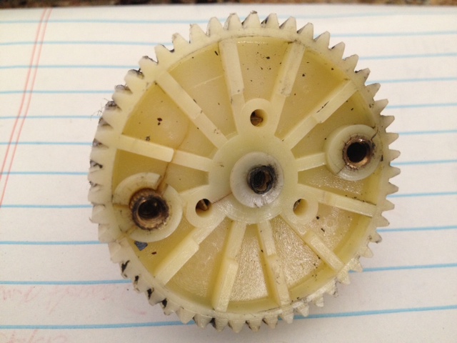

    Cracked Gear
    Attached is a photo of the cracked gear. It started where the brass insert is located. I may take it to an electrical shop and see if they can epoxy it.
    Also the gear in the larger replacement motor is different according to Marinco Tech Support.
  5. Capt Ralph
    14,605
    That is in better shape than my project. I used West epoxy with some silica filler. check your mounting requirements but it looks like allot of area to pool up some glue.
    Lightly scratch up the area, clean with alcohol and give it a try.
    Wrap the diameter with a twist tie to help keep the loose teeth in place & ad some compression to that brass insert. Use a hobby knife or painters razor blade to clean up and reshape the gear or mating surface.
    good luck

    Wiper Gear
    By the time I saw your reply I had done exactly that. I have it reinstalled and it works. A little noisy as I suspect the gear mesh is not perfect. Also I do not have the parking feature now so I will have to time my shut off to park the wiper. I think the contacts on the bottom of the gear are not making contact properly.
