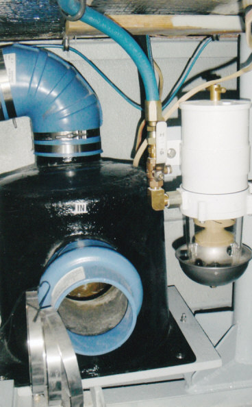

    Lift mufflers...
    Shhhh A Spit a sputter and a Shhhhh.

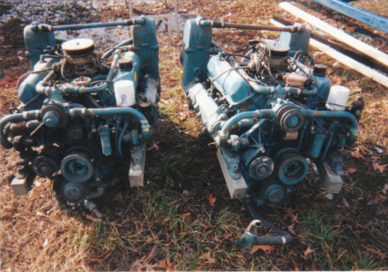

    They were sold-off years ago and are in Japan somewhere in Cobra 427 kit cars.. So you know, 427 blocks get great money... valuble blocks as they want them for the Cobra Kit cars.

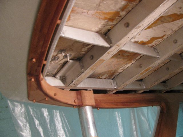

    Captain Sean takes pride in his craft...
    It's getting there, the work is detailed.
  13. homer1958
    homer1958 Member
    Feb 10, 2009
    481

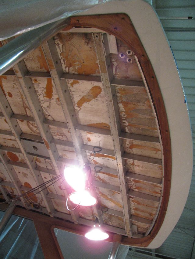

    Annapolis MD
    More curves
    Look closely
  14. homer1958
    homer1958 Member
    Feb 10, 2009
    481
    Annapolis MD
    More curves
    More Details

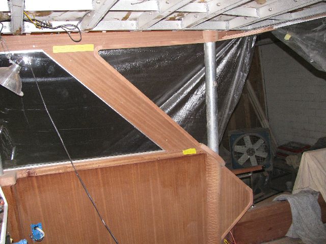

    More Curves

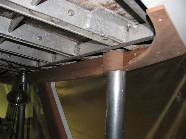

    Now, Henning said the lifespan of aluminum hull is 30 years? This is totally flase, not even close. Depends on how it has been cared for like anything else. Aluminum well cared for will outlast any hull material there is. Anyone like to disagree, feel free to comment.
    We plan to have a curtain that wraps the round rather than the cumbersome evening drop curtain. Obviosuly the alumium hardtop you see if afterwmarket to handle the bridge we made... must say this project has gotten out of hand.

    If I remember correctly, the crystalline structure of aluminum changes over time. The story I was told is that even if you put a brand-new plate on a shelf and leave it there for 30 years unused, it will change in ways that, theoretically, can lead to weakened areas. By weakened, I mean prone to cracking, stratification, and other generally bad things.
    So, yeah, you might get a crack in a weld area after a few years of service on a boat. After 30 years, you might have localized areas in which the alloy has stratified. And these are just a few of the reasons why god created welders. ;-)
    Like a lot of things said by a few guys on this forum, Henning's claim is probably completely true in military or commercial service. A person might want to think twice before converting a 30yo aluminum USCG rescue boat to recreational service. But a low-speed, recreational use, coastal cruiser made of ALCOA's finest? Puh-lease.
    Like you said--if it surveys out, it surveys out.
    You mentioned that your hardtop is aluminum, but it looks from the pictures like it's the original mahogany-framed plywood topped with fiberglass to which somebody bolted aluminum lattices. I'm guessing you don't get much flex even with a crowd up top.

    When I gutted the interior of the 38 Aluminum, I looked at ever weld in the boat in every inch of her 38 feet. Not one crack, not one stressmark. If I had found just one, I would have been concerned but did not. The boat was never absused or run hard in rough seas which may be what you are speaking of. However, she has been in monster seas many times-- 12 footers, no problem you just back off the throttles like any other boat you do not wish to beat up. Roamers have a pretty good bow flair.
    If anyone reads this and knows of an aluminum Roamer that did not hold-up, please let us know, but I have never once heard of an aluminum Roamer going bad, many of whom are older than their respective owners.
    Again, aluminum Roamers are not wood, they can't rust, they can't absorb water. Just have a decent electric meter, an epoxy bottom, adequate, yet not over zind protection, Petitt Vivid aluminum proper bottom paint and don't worry about it is my experience. I threw out that stupid battery sucking Englehard Capoc. Nobody will ever sell me on that voodoo. Epoxy bottom, PSS shaft isolaters, dry bilge, Charles Industries Isolation transformer is my formula for aluminum eternity.
    My point is if the passangers are not comfortable, then the boat is being pushed too hard. I find the 38 to do fie in 3-3.5 foot seas at about 21-22 mph.
    If you push it past that in rough water it begins to get into a more stressful condition. Most of the time we cruise at 26 mph which is 2500 RPM on the Yanmars. In 2.5 seas or less... we run her right up to 36 no problem.
    In most cases people go out boating in decent weather, so it really is not that big of a deal... unless you are into taking a beatings for fun.

    No Flexing
    This top is over-built.. think a bunch of Krauts came in late at night to build a floating bomb shelter. 20 people could stand up there. We also used the heavy 3 inch aluminum posts and we also glassed in arch supports behind the innner helm side walls.. she is tough and none of it will be visiable to the eye.

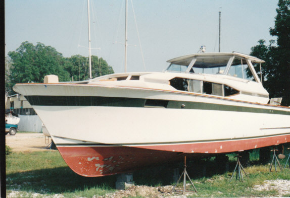

    Roamer FlashBack!
    Well fellow Shwabby's...
    It's time for an aluminum FLASHBACK!
    God that is one ugly windlass up there.... it sat here covered up for 7 years under a canvas.... Oh, no they were not going to chop her up... we got to work. Yes, she looked quite sick, like some of them do.... but underneath the acne lives very fine skin. Ya know, but prefer the blue now.. just a matter of taste.
    Don't be foiled.. it's aluminum!

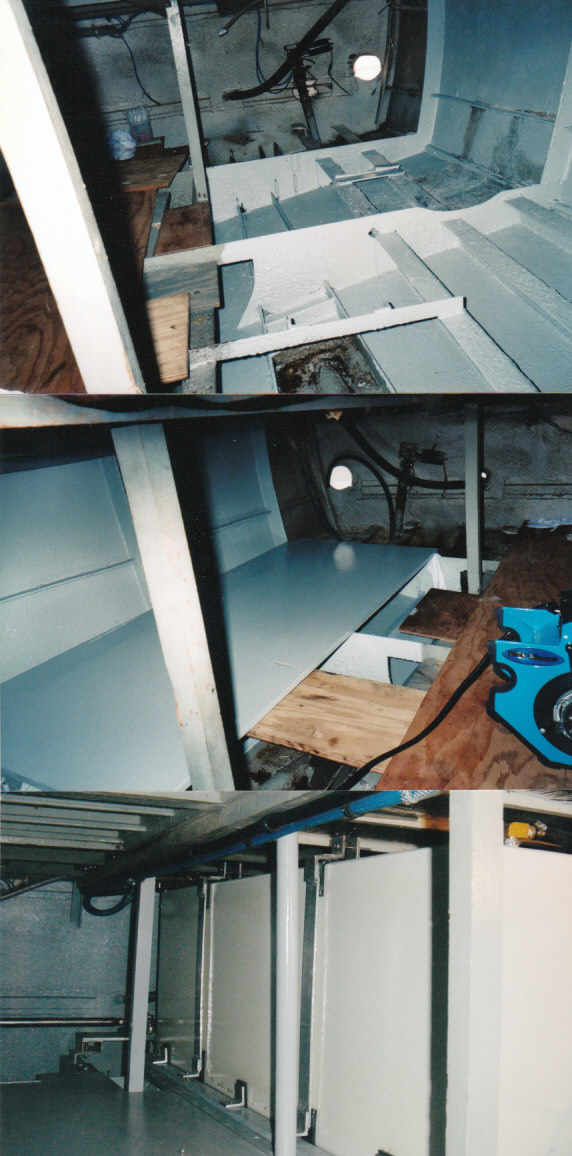

    Shower

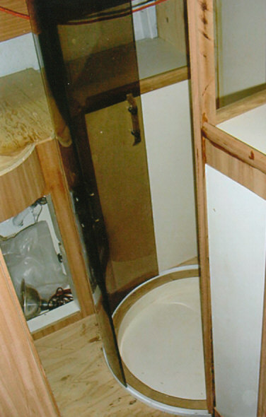

    Never did like shower set up in 38 Roamer. In 1970, they took the closet down in size and made a full shower. I like the tube effect here myself. It actually steps down and now has window in bath and full headroom. If you look closley you can see 30 gallon dung tank behing the shower wall and Vacuflsuh vacuum generator is moutned on top.. we used every inche and it all works great! This design has increased the utility and inside space of the Roamer by an estimated 25%.
    Under the floor is perfect aluminum, all was scrubbed and painted white... smells like a new boat, no smell no deterioration whatsoever. No rot, no rust, light weight and great strength... 5086 aluminum is a beautiful thing!... nothing compares "overall" IMHO. Burger Yachts would not disagree either.... afterall, they are America's floating Rolls Royce, but what do I know?
