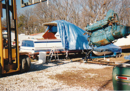

    Told you 427's Fly!
    You did not believe me now did you!
    Please do not mind the out of order sequences... the way it is...

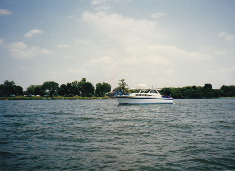

    Washington API: Roamer 38 Outruns Donzi 18!
    Unidentified Roamer siting...
    We saw her from affair passing by the Jefferson Memorial on the Potomac... My buddy hit the Nitrous buttton on his 1968 Donzi 18, She stood on end, the Roamer knowing it was most certainly another classic beast looking for some trouble, hit her throttles... But wait a minute, we are pretty sure he had something special under the hood, perhaps a pair of Commander Cody's supercharged Hot Rod Lincoln 462's... moments later the Roamer 38 vanished.

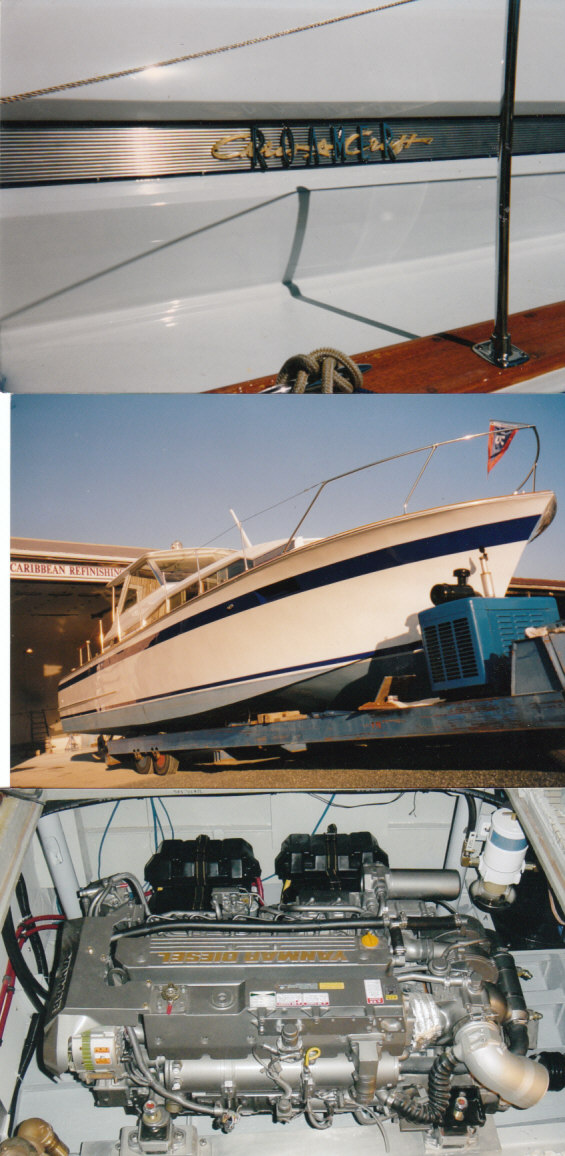

    It must have been love. wow for diesel almost like a VOLVO penta

    Ya think...
    These are several years old, but still low hours. Studied them all, Yanmar is the lightest, fastest and most fuel efficient. This is the last of the 370LY common rail mechanicals putting out 730 foot pound of torque each. 427's put out 430 and 462 Lincolns pt out 480.
    They run on Old Milwalkee or Pabst Blue Ribbon with a little Boones Farm additive for boost and are no louder than gas, perhaops even quieter. Also system has Centec lift mufflers... very quiet. No vibration either, unlike many Cummins. They are speed diesels, not work diesels.
    Yanmar is not as torquey as the Cummins, Volvo or Cat... but they are much lower profile, lighter, smaller and faster... aluminum blocks. We geared her heavy at 2.4 to offset the lower engine torque.. she has 23 by 31 (4) blade wheels.. monster props so is real good in the big waves, pick-up is fast and mid range boost quick.
