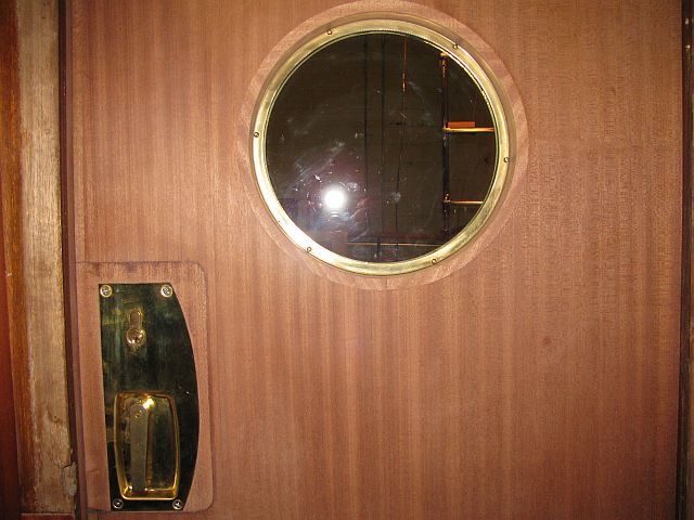

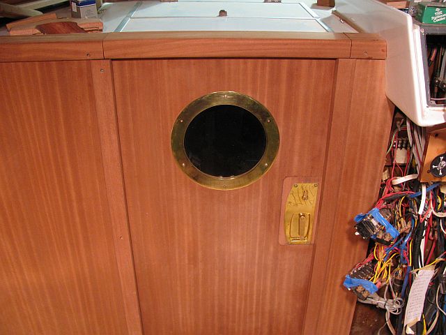

    Pain in the Transom Lockset
    It took three days to put in the lockset and porthole window which will be a two way mirror. Will something please go easily on this job? Nice inlay detail on porthole. In the end, you can see out, but not in.
    By eliminating the swing door open up many future options for the cockpit spacewise.

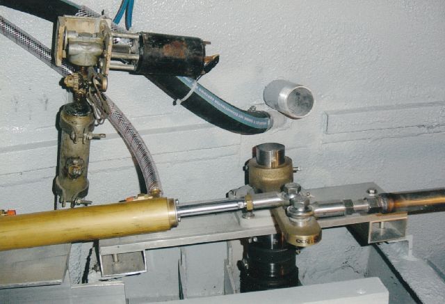

    I shall post a photo of our 2008 PSS hydraullic rudder system. Please feel free to post yours. Let the audienece decide what they think. I certainly can learn a lot from many informed Roamerfiles on this site. I am not a know it all. Always eager to learn new things and to be corrected as well.
    There is no contact between this rudder post and the hull per se, bushings are isolated and the aluminum grade matches. Even if they did touch, I would think it is fine.
    This was manufactured to military spec by the folks who have the Navy refit contracts on the Chesapeake Bay. I wonder if it is legal to put a machine gun turret on the foredeck?
    Many Roamer captains who took out there bangy rudder posts noted the steel shafts had rusted away to a degree, in sum less diameter than when new. They also have atendency to seize if not cared for if a Roamer sits too long.

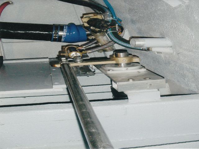

    I have heard of three different alloys used on the Chris Craft hull skins, 5052, 5086, and one that I can't recall right now, but I've never seen anybody bring forth anything to demonstrate for sure which is the one the company actually used. It seems odd that they'd have used a "superior material" for the 38s than the 46s. You wouldn't happen to have documentation on the 5086, would you? I know of at least one other Roamer owner who'd be extremely interested in seeing that.
    I'm guessing that none of the aluminum boats with worn out steel rudders you've mentioned got a shot of grease in the fitting every few years. If there's an issue for Roamerites to debate, my point is only that steel's a fine rudder material in an aluminum hull SO LONG AS you're greasing the log and using the vessel. Otherwise, things end up looking like this:
    [​IMG]
    On the rudders, I don't have a pic of mine installed. But anybody who's seen a Buck Algonquin spud attached to a log by a hose knows what the stuffing boxes looks like. I think it was $100 for the pair, with hoses and clamps. They're totally dry and turn very smoothly. Since bang for the buck is a consideration, what did your PSS's cost you?
    Anyway, here's the new rudders, rod, and cylinder before install. The wide angle lens makes it look like the rod is bent, but it's not. I went with HDPE bushings to isolate the stainless, but I do wonder if I created an environment for crevice corrosion in the process... Time will tell. Also, the cylinder is fully rebuildable.
