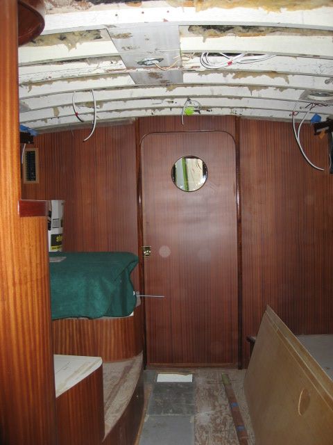

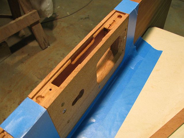

    A few of you have been writing private e-mails regarding cabinet work and other trades.
    Here is a few pictures of Captain Sean's joinery. He is installing an Italian heavy duty lockset and port light.
    New photos will appear as things progress. I shall let your eyes decide and vote.

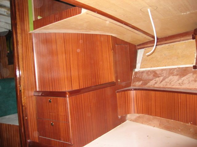

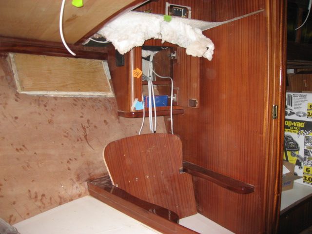

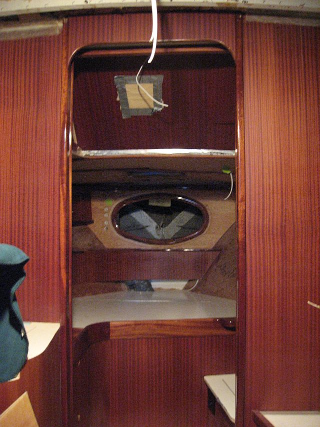

    New Bow Design!
    We decided to get rid of the vee birth and come up with a double bed. It is great sideways.. plenty of room. Note the hand made bow anchor locker. It will have a back- lit mirror with the Chris Craft Logo etched in the mirror. It opens and closes on a piano hinge.
    Note the drawers but we did take out the two closets and lost this space but we gained a larger boat, drawers, chair and an open look. If you look on top of the drawers, you will see the future flat screen TV wall that is designed for a 23 inch Samsung. Thank God I waited, the price of the TV is 1/3rd what it would hve been a few years ago.
    I would say overall, we gained about 25% more space in the boat more than the factory design. We used every inch we could find and the tolerances are that tight.
    It sounds crazy, but there were no plans, no nothing but my head, a pen and a few napkins. It happend to work out real well.
    If you look closely you will see the side walls are cold-molded. Note the curvature, it also increase the bow size. In sum, we built into the hull and found a ton of dead space that is now living space... more open, more bright.
    The windows were taken out and a 10 pound porthole that opens was put in its place. Again, had to buy it in China and it cost not much over $100.
    3M Thinsulate is behind it for insulation and quiet. Chris Craft had no insulation whatsoever on the walls or the ceiling. Well it does now and Thinsulate will not mildew.

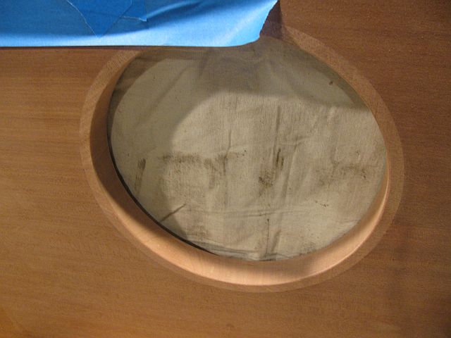

    One Way Mirror Porthole
    Well, in keeping with doing cool and unusual things.. the door weights 45 pounds... the porthole is a two way mirror... you can see out, but you can't see in. Note the extra width of the door vs. the factory. Again this opens her up and gives a lot more space since th door disappears.
