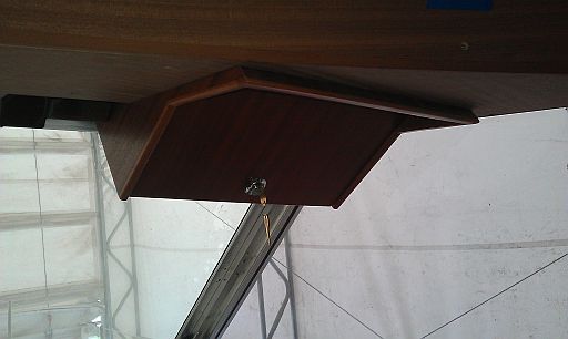

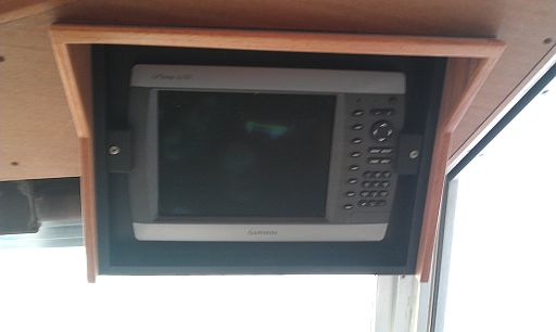

    Well this one was tricky.. how to build a nice navigation center that does not look like an add-on basement job that you can lock with ease. Well Garmin has the goods.. they got it and man is it easy to use and does it all. I studied RayMarine too.. Garmin 1200 won by a long shot in my books.
    Now you see it, then you do not. We built a curved header above to fit it in and it looks great (two dimensional header peice will get header white padding, enough wood ... you can see out and it obstructs nothing much.

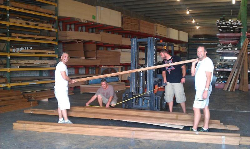

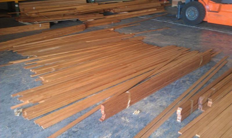

    Well.. we have learned a few things about Teak along the way. First, Teak is not Teak.... you have to hand pick it from piles from the right place with trees grown in a certain slope in a special forest in Burma. It should be quarter sewn vertical grain golden with few if any knots or pinholes.
    Well, I grabbed a $99 flight to West Palm to the supplier of the nation's finest marine hardwoods. The same place Teak Deck Systems and Ribovich gets their wood.... or some of it.
    These folks were very helpful and took their time to teach and assist in the selection process. Any of you looking for any type of wood can find it here at a fair price, not cheap but not over-priced either... bottom line is high quality.
    We looked through many piles of beautiful Burmese teak... and picked each board until we had what is known as "Super Deck" or A++ grade teak from older Burmese Teak trees 60 years plus... otherwise known as Tectona Grandis. Each board is 1/2 inch thick and 1/7/8 wide.
    In the following photos you can see the results.... I recommend anyone looking for teak or any exotic lumber of veneer to call these boys and ask for Jeff.... I mean if it grows, they got it and they won't rip you off.... most rip-offs are reserved for the state of Maryland.
    I am not a fan of fake teak decks (Plastique or TekDeck).. they get hot and really are not that much cheaper. Would you rather wear a polyester suit or a wool suit?.... plus wood is far less slippery and more beautiful.

    Let's take a peak..
    Here are the boys at West Palm Beach....
    They have two outlets, one in North Carolina and the other in Florida.... selection is a bit stronger in Florida, but both offer a lot of wood. If you are upgrading your Roamer... this is the place to shop for wood... they even various selections of carpet teak carpet in a variety of colors for those looking for teak carpet.

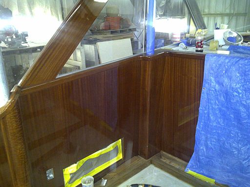

    Chris Craft used a 3/8th inch ribbon stripe Sapele veneer. What you are looking at here is 3/4'' ribbon stripe Sapele from Greece (no longer available) with Coast Guard approved sound deadening material sprayed on the back with 2 inches if foam sound deadener. Though it does not look much different than original except the poles are bigger and the African Sappele Mikore wrapped poles for a bit of an elegant touch. This finish will get blocked one more time and buffed just like a car. If you look closely, the triangle part that used to be removable plastic curtain is now sold tinted safety glass. I run around doing this or that and installing much myself. Everything was earned the hard way.

    You are going to have a real gem there when finished! Homer, could you describe, either here or in PM, the process, and products, used to achieve this finish?? Trying to improve my finishing skills. The depth of the finish is amazing

    I do not recommend trying this is you are not a pro or not with one... the process is very time consuming and has to be done just right with the right products. I have played around with this stuff on this boat for over 35 years.. remember this was my dad's boat he bought new when I was only 12 years old. .. and it was near junk 10 years ago.
    I believe in learning how to do the prep and do it right and then calling in the best sprayers you can to shoot it... it does not cost much that way.. they charge for their time and spraying is fast.. it's 95% prepwork.
    "Enrique" will fly to you and his hourly rate is around $30-35/hour plus a shoot fee. I have yet to see anyone spray Awlgrip or hold a gun better plus he is a very nice person and no crotchity "Painter attitude." Air Tran him for $99 bucks. Plus, Enrique does works like a whirling dirvish... believe me twice as fast as the normal worker.
    If you send me a private message with your phone number I would be happy to share ideas with you though. There is no "royal road to geometry" here... its hard work and patience beyond patience. If you are tired of you wife and pray for her to leave you... restore a Roamer... that should do the trick :)
