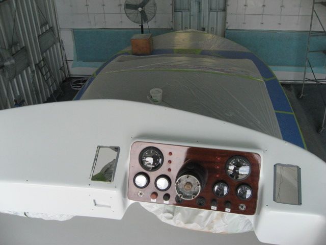

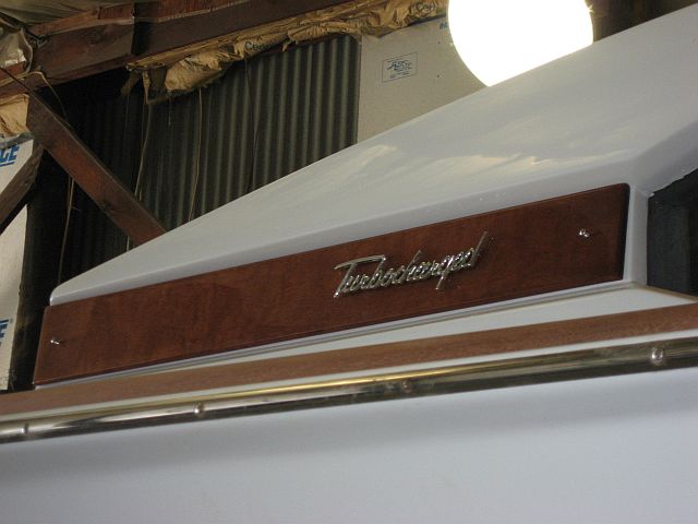

    Bridge dash...
    Custom made in my parttime... real Sappelle with several coates of clear.. today complete top is mahogony wood veneer... 3 coats of epoxy, 7 coats of Dupont 7900s automotive clear.

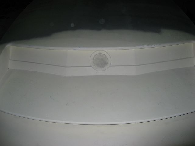

    Cool....

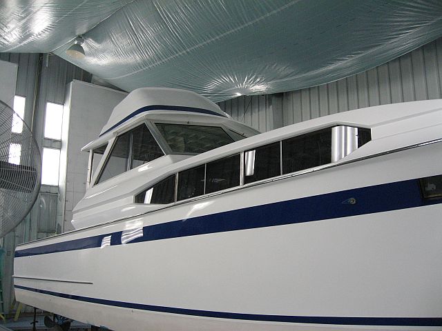

    Well, bye bye windows... glassed in 3/4 inch mahogony and added a 10 pound opening brass/glass porthole.. Open her up underway and get a nice strong breeze... more bright inside too as we added a new cast aluminum hatch in the bow. No chance of a leak anywhere, stronger too. The interior is now a double bed with a large built in chair as well as several drawers. Wait until you see the custom bow lounge we will put here.

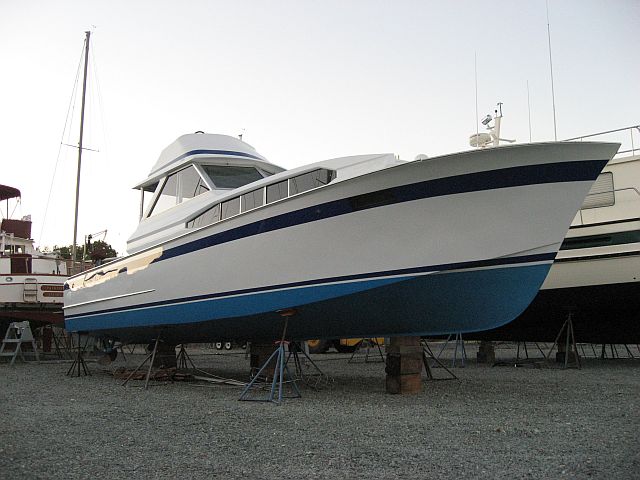

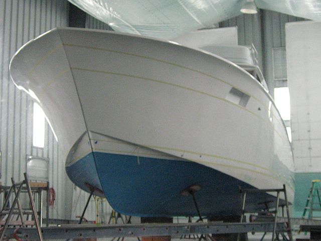

    But I want to see some stripes...
    A Roamer must have it's famous 60's stripes... would you own a 1969 Chevy Chevelle SS without its hood stripes.. same thing, same era.. just like the Cobra 427.. and Yes, the 1969 Roamer engines were 427 cobras.. that is what she came with. They said it did 34.. we only saw 33.. Dad wants his money back :)
    The striping is very tricky.... takes quite an eye.

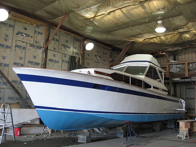

    Don't forget the Royal Blue stripes..
    Stripes were big back the, 427 Cobra, Chevelle SS, Donzi, Magnum, Cigarette... and of course, your Roamer... no stripes, no Roamer. Note the progressive striping.. not so easy to do by the way... at least to get right.

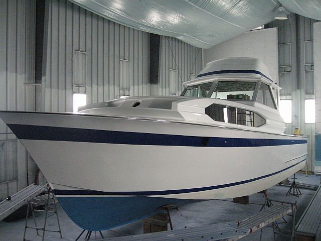

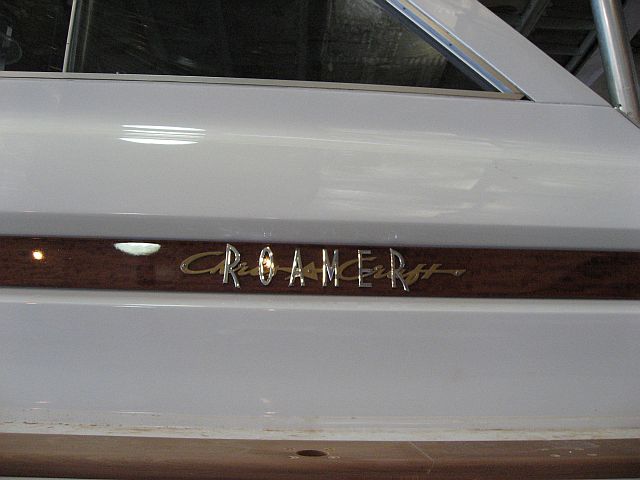

    OK.. More Stripes...
    Stripes

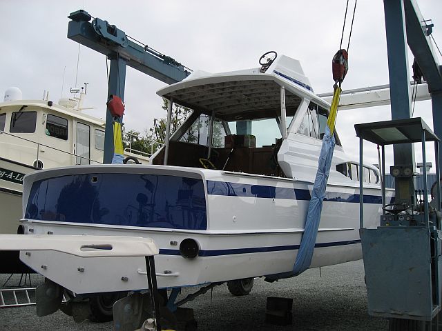

    Let's throw on some wood....
    Stainless strips bye bye.. Mikore via Africa.. here we come.

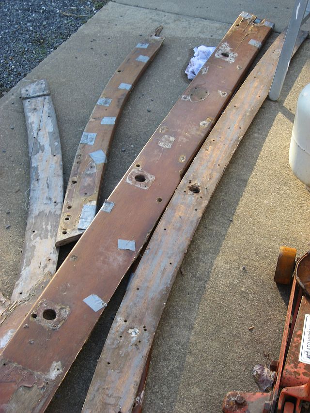

    Roamer wood
    Unless your Roamer was well protected, usually under the wood corrosion will or can start, partiuclarly in salt climate. Chris Craft did not seal the wood underneath and why the plugs start to pop varnish... it is moisture from underneath! You can see the Dauphinite raw wood in this photo. Also, the absolute best bedding compound is not 3M 4200; it is Skikaflex 291 lot mahogony color... this stuff is really great!
    We spent $600 on new Sappelle Mahogony and used the old toe rail as templates. Three coats of Maas epoxy then 7 coates of Dupont 7000S Chromaclear automotaive clear, sprayed in two sessions sanded between then rubbed out. Yes, it is like glass, and yes the whole boat was covered in "Sharkskin" during spray.. same as autobody work... fine indeed and all chrome is re-dipped tripleplate, all posts electro-polished. All post holes were over-drilled and screw molded with West/Silaca molding... water can't get in... no way.
    Maas and Dupont Chromaclear have good UV value.. if you do not use the right UV.. you will lose your epoxy. Chromaclear repairs with ease as well.. it's thje perfect product to spray your wood with if epoxy based first.
    Again, I have seen so many people buy Roamers and not do the proper things in terms of restoration; Roamers are not Puerto Rican Mildew Tiki Barges so please do it slowly and well. Remember, if you walk into an old boat and it smells musty, this is mildew and it is not healthy.. any more than it is in your home. Roamers should never smell musty, they are not wood or water-logged old fiberglass... they last forwever if you take care of them.
    If you do not take it down properly and build back, all you have is an old stinky boat. BUT, if you go at it and really go at it, a classic bullet-proof gem is waiting in your Roamer. People will gaulk at your boat in amazement... meanwhile a 400k Sea Ray goes by some poor goober is paying $1000 a month for forever... and nobody cares about common clorox bottle floaters that everyone else has, nothing special... herein lie your opportunity. Roamer hulls are faster and roll less too!

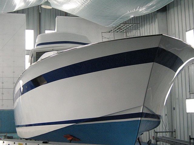

    I would not use the same paint even if you can get it because it is old technology. I would use either Sterling, Awlgrip or Alexseal. Alexseal is the newest technology as it gives you the hardness of Awlgrip but is easier to repair than Awlgrip. Do not spray this paint yourself... it is highly toxic and subject to drips. Do the preparation you want yourself with proper instructions but it is worth hiring a pro to do the spraying.
    My colors are really a great shiny combination.
    Awlgrip "Vestal" White
    Awlgrip "Royal Blue"
    Deck is nons-skid 55%% "Bluetone White" mixed with 45% "Vestal White"Five parts course grit sand w/ 2 parts fine sand (Awlgrip has proper sand product) mixed with 75% flattenig agent (Awlgrip product as well)
    The chemist who invented Awlgrip is the same chemist who formulated
    Alexseal to improve on the "problems" with Awlgrip.
    Yes, I know Roamers very well and this boat has been in the family since new. Did you know the famous crazy motor cycle stunt man "Evil Kinevil" and trial lawyer, F. Lee Baily both owned Chirs Craft Roamers?
    This is for professional sprayers to spray... most of the work is "preparation".. actual spraying only takes a few hours.

    She's a Roamer... bad girls need to be anchored!

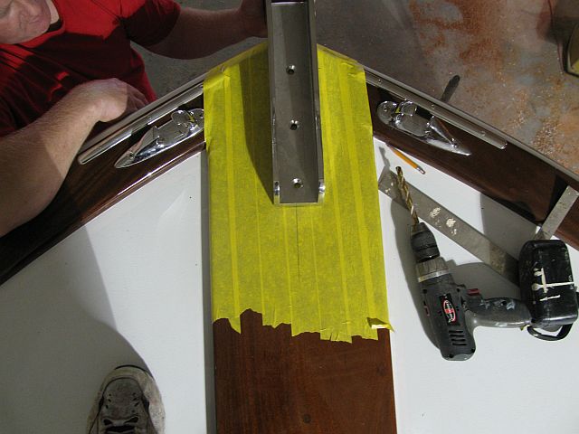

    If you look closely at the wood, you will see the new Sappelle Mahogony I busted arse on. Three coats of Maas Epoxy, 7 coats of Dupont Chromaclear 7900s sprayed and buffed. She's is all dressed up... pearls please...
    Note the Anchor Roller being installed.... checked Windline and a bunch of them and thought they were El-cheapo. Nice highly polished stainless anchors were horribly expensive. So I got online to DongYing China. I could not believe what they made for her custom. A beautiful 22 pound mirror polished stainless steel roller and a 35 pound 316mirror polished plow anchor. See it being installed today Dec 3, 2002. Dennis was amazed at the quality... He too wants to know where to get this hardware so reasonably.
    The King Plank we made. Cost of the anchor from China $160.00, the Roller $99, the quality real nice (Yes, I was worrried about Chinese quality, but they did "GOOD"). Everyone wants to know who made it so reasonably? Well, shoot me an e-mail, these people have a large online hardware catelogue that makes Perko look like Garbonia. In USA, that combo would cost you around $2500. I was not going to pay that... way too much... e-mail me if you want to know where to see the online catelogue.
    It's nice to get the anchor off the deck.. real tripper and a waste of space otherise. One more thing.. if you note, I have looked at a lot of Roamers.. "the devil is in the details".... see how clean the white deckline is where it meets the wood. Well, if you are going to do your deck, use 3M striping tape if you want a tight clean line or you just get that "I painted it with a broom look" but saved Five bucks. Can we elevate just a bit.

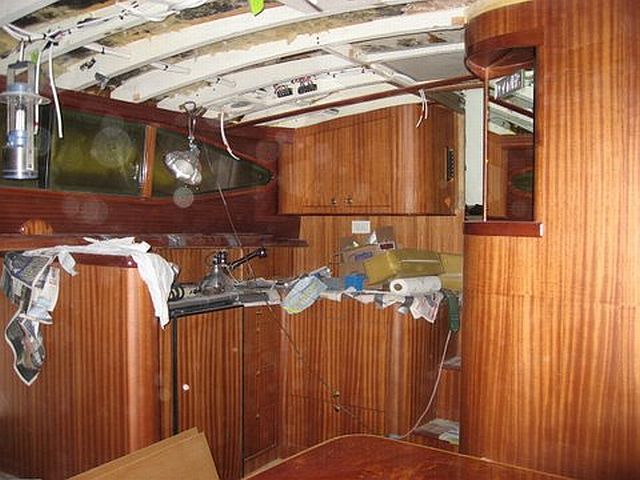

    She was gutted. I mean gutted. Who knows what could be lurking under a 1969 Monomatic head (Revolutionary at the Time)... Well, since my photos are a bit disorganized we will shoot them as we get around to it.
    At any rate, It was clear when we ripped-out the floor and everythig else that the hulll was perfect, not a bad weld, not a pockmark.. notta. She was well-bathed and painted white.. she smells very new.. The new smell.

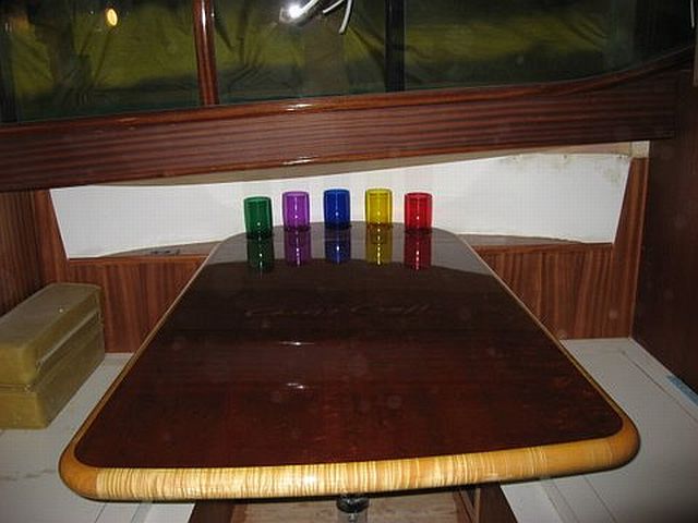

    The interior build began... I will bait your eyes first with the handmade bookmarked African Mikore table with the Fiddleback Elm trim. She nicely compresses down into her groove to make a double bed... No more taking that obnoxious table off that weighed a ton and rattled underway (You probably know what I am speaking of.)
    The glassrack is lit from underneath with a small flourescent.. the leather pleated dining cushions will wind around and it will be Ya know... maybe a bit "Neauveau Greco Iti"... i.e some Erurpean flair.... about 5% Puerto Rican, but no more :)
    Look closely in the center of the table and you will see a Gold Leaf "Chris Craft" logo imbeded. The table was then automotive clearcoated and buffed. If the mirror breaks you have a place to shave. The wood is exotic... you are not quite sure what it is but it is definitley exotic.
    We built into the hullside depth hence the boat is about 25% larger inside now, note the curvature of the white back area.. the pleated diner will wrap around with an oval mirror behind the glasses... at night a subtle glow.
    All glass is new and tinted.. tracks are new and the stainless type with the air sealing fuzzys (nothing wrong with the original plastic ones either.. both are fine)
    The idea is to be as nicely appointed as a slick Limo, but sans the cheese.... all shall remain classic, a bit flashy.. not too much though.

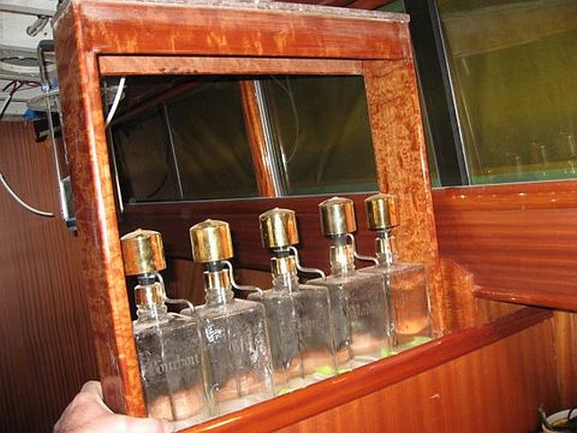

    A secret agent Bar?!
    You must be joking!! Well, now this is an original idea... well sort of. I would go to boat shows and dream of owning one of those Sportfish beauties... but like most of us, that is never going to happen. But, the salesman was demonstrating a TV that was moving up and down inside a coutnertop. Boy was that cool. sure some of you have seen this one... BUT,
    Have you seen a bar do this?
    No you have not... know you do! It is operated by an electric piston and even has a remote control button like a TV remote... so cool, each bottle is labled as to what's inside it. Here is what you do... load it with the cheap stuff for druken shwabby types, but keep the good stuff hidden. It is near impossible to know this old gal is loaded with booze, but it disappears in a flash. Martini and high ball glasses will hang upside down and the bottom of the bottles will be lit from underneath as she activates.. how cool is that?
    Look closely at the wood, it is "African African" Pommel Mikore as well... the countertops are made of Avonite.. real cool stuff with metal flakes subtley ingrained that reflect night light... can we say Peurto Rican or Limolike glitz?
