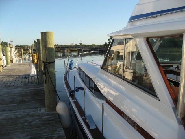

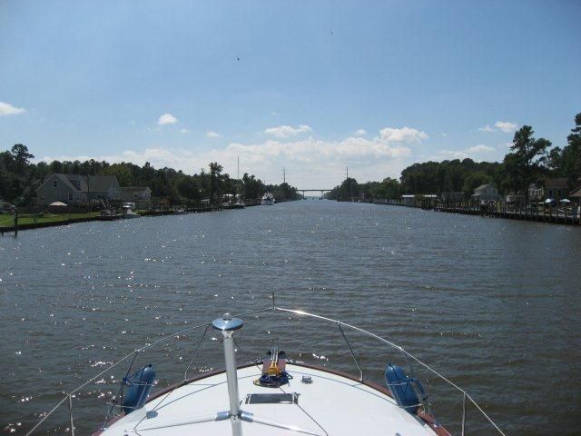

    We are leaving Cambridge MD ... Thank God

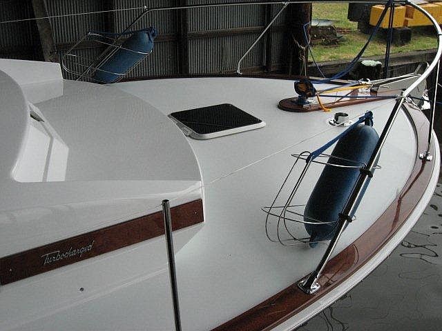

    ToeRail
    Yup, that toe rail is as nice as it looks BUT, it took forever... you are not looking at varnish.. you are looking at three coats of epoxy (Maas) sanded to baby's butt smooth, two sessions of 4 coats each of Dupont 7900s clearcoat sparyed, then rubbbed... YES, you have to plastic up the whole boat to do it this way.. not recommended unless you really know what you are doing and have a place to do it. Basicaly, same as an automotive spray job.. not a piece of dust in it.

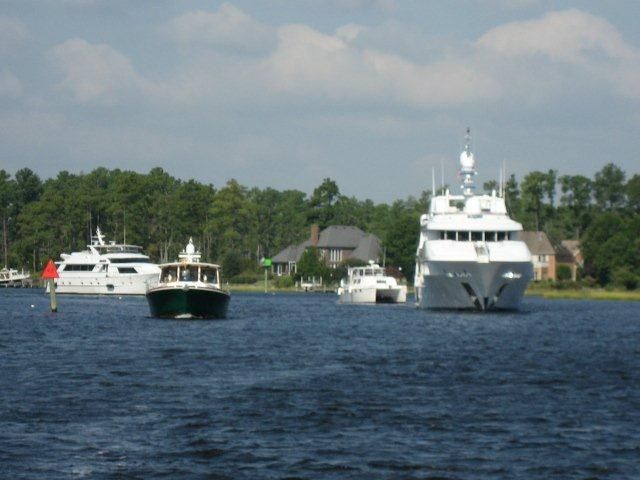

    Albermarle Sound
    That's one shallow nasty piece of water there... Sheeesh, the waves were big ... soon we will be pulling into Nagshead... where she rests inside all winter for her final operation, polish off the interior, build a new single hatch and lay a teak deck which I am trying to get from Burma.. that's another hassle... I am also looking for a 12 foot bow sprit.. a hand carved mermaid would work.
    Everwhere we pulled in people were asking if it is a restoration or a new one built from original plans. I said look at the deck.. it looks like crud.. but soon we will get that handled. There are more lose parts hanging on that deck.. like the chicken business.. "Parts is Parts." People don't know what a Roamer is down there.. did not know Chris made metal boats. Look closely and you can see a porta potty in the back.. my bud is a bit soft I think...

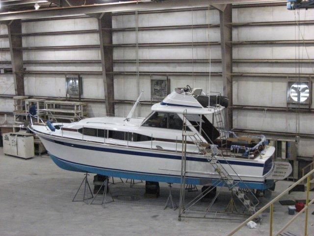

    Ahh, Back in Drydock
    27 sportfish plants.. 24 out of business in the Nagshead area.. all kinds of great skilled labor there at a reasonalble price... what you won't find much of in Maryland. They have lots of attidtudes and high prices though in MD if that is what you want.

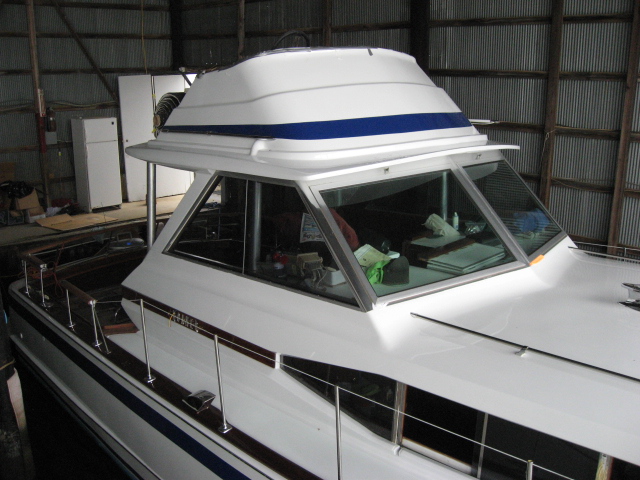

    Restorations are tough, but for those who are doing it.. well, keep chipping away and the day does come. For those who have corrosion seeping out under your toerail.. well, you can't really stop it unless you rip it off, use the old as a template ect. You will find it is not pretty under that toerail, water gets in fresh/ or salt still gets it. If you decide to do it, seal the wood with epoxy all the way around, bed with Sikaflex 291 lot, (not Boat life.. "Garb") overdrill your station holes fill with Colida Silica mixed with West System and you wont ever have the problem again. 4200 3M is OK, but Sikaflex 291 lot is way better.. I've tried them all.
    When it comes to wood/brightwork.. use Maas over West. When it comes to structural I prefer West. Maas does not blush, is more clear and and has UV in it whereas West blsuhes and does not have UV. UV is critical or it will peel off! West says they have a new product that does, but not sure? I have found Maas as an epoxy base then multiple sprayed Dupont 7900s clearcoats is the best way to do it. Now there is a more clear plastic/automobile clear look to 7900s than varnish which has its own look, but I just did not want to spend my life vanishing. Dupont 7900s is easily fixable by spraying and rubbing out.. it is also a softer clear coat than some so works better with wood/exoxy systems with the natural flex expansion and contraction. Though you can't see here, there is a one inch border on either side of the nonskid. We mixed 3 parts rough sand and 2 parts fine sand (Awlgrip sand) in the Awlgrip and it looks like it came out of a mold. So much of this is technique... and hope you have a lot of patience. Yes, all the glass is new tinted safety glass. I prefer safty glass to tempered because it is more soundproof and is not at all wiggly like tempered can be and usually is. No the stantion caps are not on here, that is only closeline for now.. need to put on the new cable first.... We really enjoyed the trip, mostly blowing by new Sea Rays and all those kinda boats in something different that goes even faster than the new ones. This is not a sport, it's a disease and terminal immaturity is part of the disease's symptoms... they have not found a cure yet.. oh well.
    Again, this one is a 1969, hull #5 of the 7 made in aluminum. They made 12 in steel in 1969 so there are very few 1969 38'ers left. The 37 is nice which they made between 1965-1968, but the helm top was one foot shorter.. that and the one foot in the hull is the basic difference.. so not much anyway.
    Last but not least.. one of the nice features of alumimiun other than high strength to weight ratio is that is does not "mustystink" like old wood or old fiberglass... it can't absorb water so it can't attract mold. A midew smelling boat is MOLD simple as that and we all know it is not healthy to breath. Aluminum is a hull to desire, it truly is. Roamers are a perfect boat to restore, but the commitment is really big. So, a great one to choose, but be prepared, it will test your fortitude over and over. If you are thinking of doing it or are doing it now, PLEASE do it right.. I mean right, you will stop the show everyplace you pull in... there is something special about Roamers.. something strikingly classic people just like to look at... perhaps it brings them back to an era in America so many of us miss who are old enough to know the difference.
    1969 was Detroit and Michigan at the top of the American Golden Era... That's cool, That's the real America.. the latter days of the real Chris Crafts... an era gone by, one I hope you too will try to restore and keep the memory alive.

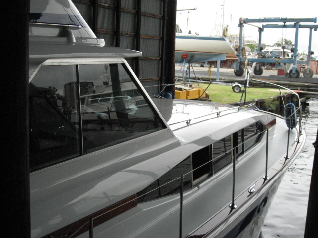

    Updates
    Enjoy photos.. almost there if she survives Irene... that is.

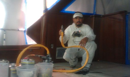

    Mexican terrorist getting ready to shoot Dupont Chromaclear 7900s over two coats of superbly prepped Maas Epoxy. No drips, no orange peal... can we say Bentley?

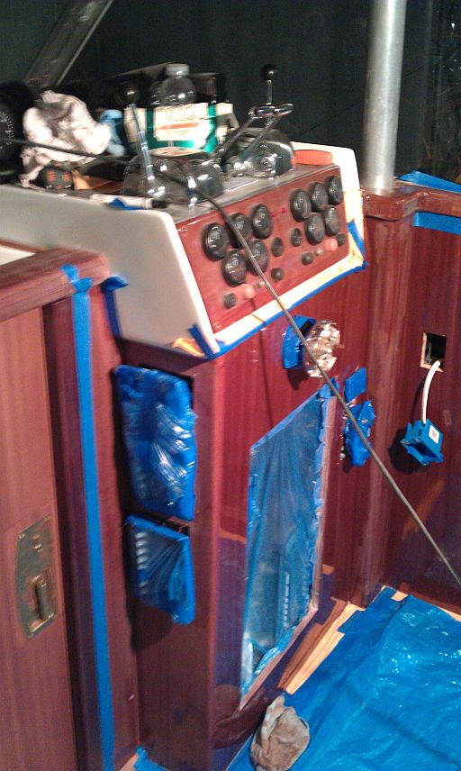

    Helm
    Getting ready to shoot.. built-out, all electric in helm area, new breakers/wiring.... no more bending over under the seat.. ouch.. dumb Chris Craft on that one. BUT... you must have hydraullic steering mods to do this because otherwise the original steering pipe is in the way.. plus you need to build-out the helm to do it.. it's not recommended.. a real big job.. how patient are you? Oh boy.. tough one here.

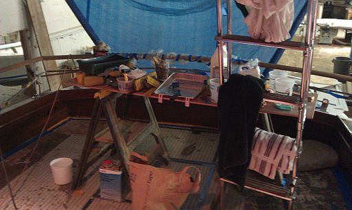

    Homer's Desk
    Please don't mind all the disorganized sandpapers.... sign of a mad water-logged scientist. Trick is to master prep, then call in the pros for a few hours.. that's how you do it right and cost effectively.. but good prep is a real discipline and patience is a virgin. They don't call em she's for nothing:)

    Mexicans work cheaper and harder
    Grab a few Mexicans from a sportfish builder and they can really work!
    Occupational hazzards abound.... Man loved tacos for lunch... area flammable... and not from the chemicals... industrial fans recommended at all times.

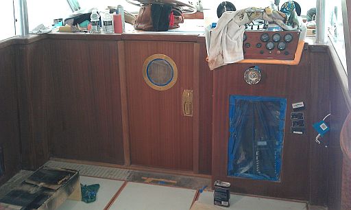

    The Door
    Well, buiding a slider is tough, but saves a lot of space and offers the opportunity to build a Nav Station area lounge. This door is solid Ribbon Stripped Mahogony with a brass porthole... Heavy. This will be a two way mirror porthole.. see out, but not in... i.e.
    Anyone looking for good boat parts of quality.. try "BrassWorks" online.. they got a lot of cool stuff the boat companies buy stuff from. The lockset is from Italy.. its cool, though heavy.. she slides smooth and closes like a vault.
    Reason she is lighter color is the door was not epoxied yet.. epoxy and finish does darken the wood considerably.... golden Burmese FEQ1 quater sewn 1/2 inch teak deck will offset in the end... so no biggie. We used a large piece of flat formica Frosty White for the binnacle area.. came out beautiful.. no more paint there.. Yippie!
    Now those old engine hatches weigh a ton... saggy, rotty, clumsey Roamer hatches.... THEY ARE GONE! Look closely on the deck.... here is a great solution. Nidacore Honeycomb! I mean I do not think a hatch weighs more than 8 pounds, is very strong,... can't rot and are very sound retarding.. but must be banded... another pain. This is what the sportfish boys use now. They are built into an aluminum track with a waterway.. spray all you want.. water runs into a gutter and out a pipe and out the drain.
    Neopreme seals the edges so no sound comes up or not so much as before. Though you can't see it.. all the side panels are 3/4" Greek Shelman Ribbon Stripe Mahogony sealed on both sides, sprayed behind with Coast Guard approved sound retardent with a two inch layer of all foam SoundDown. We added some wieght, but we also took a lot out.. in the end, we are a heavier boat though. Who cares.. aluminum hulls are so light anyway. We don't like noise unless it's the Beatles, Stones, Herb Albert or Burt Bacharach... NO RAP music.. what's with those angry Tarzan jingles?? I think those tunes come with new Sea Rays with fool's gold keychains... No? Shows you how society has progressed. We create our own way thank you.

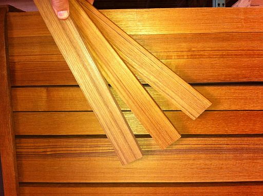

    Let's talk teak..
    Now.. what are your options?
    Glass it with nonskid... sorry man, we are not into that look. Or you could go with original GenCorp white decking material which actually holds-up quite well and is reasonable, or Fake Teak.. but, it gets hot, the black rubber smudges the plastique and it really is not cheaper at all if you find the real thing right! Real teak decks are so resilient to slipping and do not get so hot.
    What do you ask for?? Well, you need to know where to go and who to deal with. You want FEQ1 quarter sawn, tight grained vertical golden.. amount of tiger stipes in the wood is a matter of personal taste. It is grown on one special slope in Burma or as they say, Myanmar. Political problems are an issue and teak can't be directly improted from Myanmar to USA. DON'T use carribean plantation teak!
    Burmese goes to India or China first. Some like the perfect blond stuff with no character, others like a bit of tigering which is my preference as it lends such natural beauty. Teak does not turn gray unless you fail to oil it and wash it down. It is not so high maintenence.. a varnished tow rail is what will get you.. oh boy it will! Oxolic Acid (The active ingedient in Wood Bleach) in a bucket of hot water will turn your teak golden new again in minutes.... $8 bucks at Ace Hardware. But neutalize with baking soda afterwords, wash down with mild detergent, let dry.... Teak Oil, then WOW!!
    We will make a waterway along the rear.. you know how the water likes to slush around the back a bit.. we are ending that program too and increasing the scupper diameter. Teak will be 1/2 ich thick, 1/8th grove and between 1.9-1.75 thick.. hatches will be bordered/framed.
    It's a good idea to go pick-out your own Burmese teak from 30 year old trees miniumum.... anyone looking let Homer know and we will hook you up right.

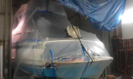

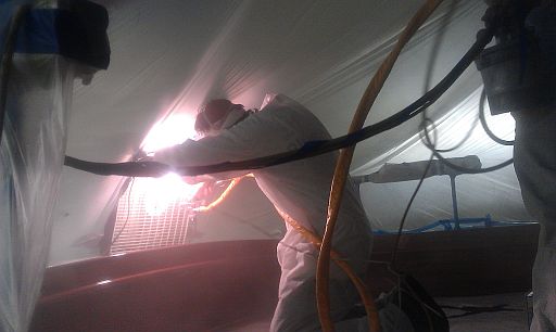

    Spraying.. such an ordeal
    Maybe not so bad... here is our Rube Goldberg spray booth.. well it worked.. no dust, no nothing... we covered everthing with fresh plastic and provided a fan.

    Spray away men!
    This is coat one of 5 in the first shoot. The Chromaclear is so shiny even a micro error in prep magnifies. We must sand it down a bit and shoot again.. with all the sheen it is easy to see the imperfections.. THIS MUST BE "Durablock" FLAT BLOCKED! I ran the DA a bit much, but it is ok.. just have to make a couple of days more work.
