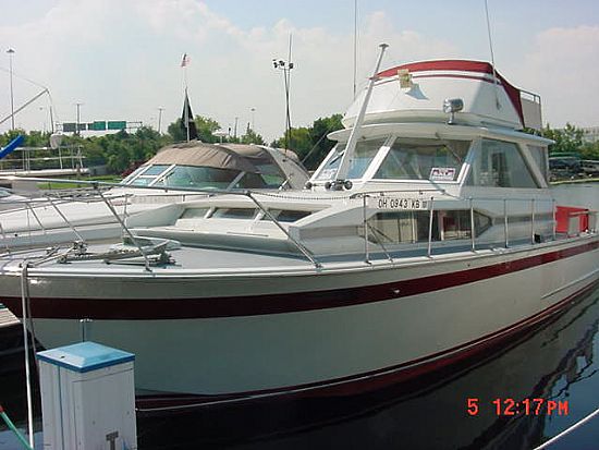

    Roamer Pics
    Here are some pics of our 69 38 Regal Sedan. Homer should like this; We bought it last year - on the Fourth of July!

  17. watjam
    watjam New Member
    Feb 2, 2006
    68
    We hail from Huron, Oh.
    Roamer Pics
    This is the only pic it will except......how do I resize?

    She's sweet Watjam!
    You have a full load of fuel and water? She is sitting a bit low in the rear, or is that just a few hours supply of beer?
    Is she steel or aluminum? Steel does sit two inches lower as it weighs 4,000 pounds more.

    Thank you Homer, I shall overcome - (technology, that is)
    You know, I thought she looked low in the saddle too and no she's not
    steel. The previous owner placed the water tank up forward - under the dinette seat, he must have thought the same thing. all that's left back there is a big ol' 6.5 kohler generater that I never use. Thought about eliminating that and going with inverter. Did the sedans sit a little deeper
    because of the extra weight?
