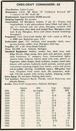

  8. Laurence
    Laurence Senior Member
    Aug 30, 2006
    248
    Chattanooga TN
    Fuel Burn
    Even though this attached schedule is from a 38 CC Commander, I find if very close to my 38 Roamer. I thought it might be helpful for your info.
  9. Fireman431
    Fireman431 Senior Member
    Jan 11, 2010
    195
    East central Florida
    Can we still get one for $31,990? I'll take two...:)
