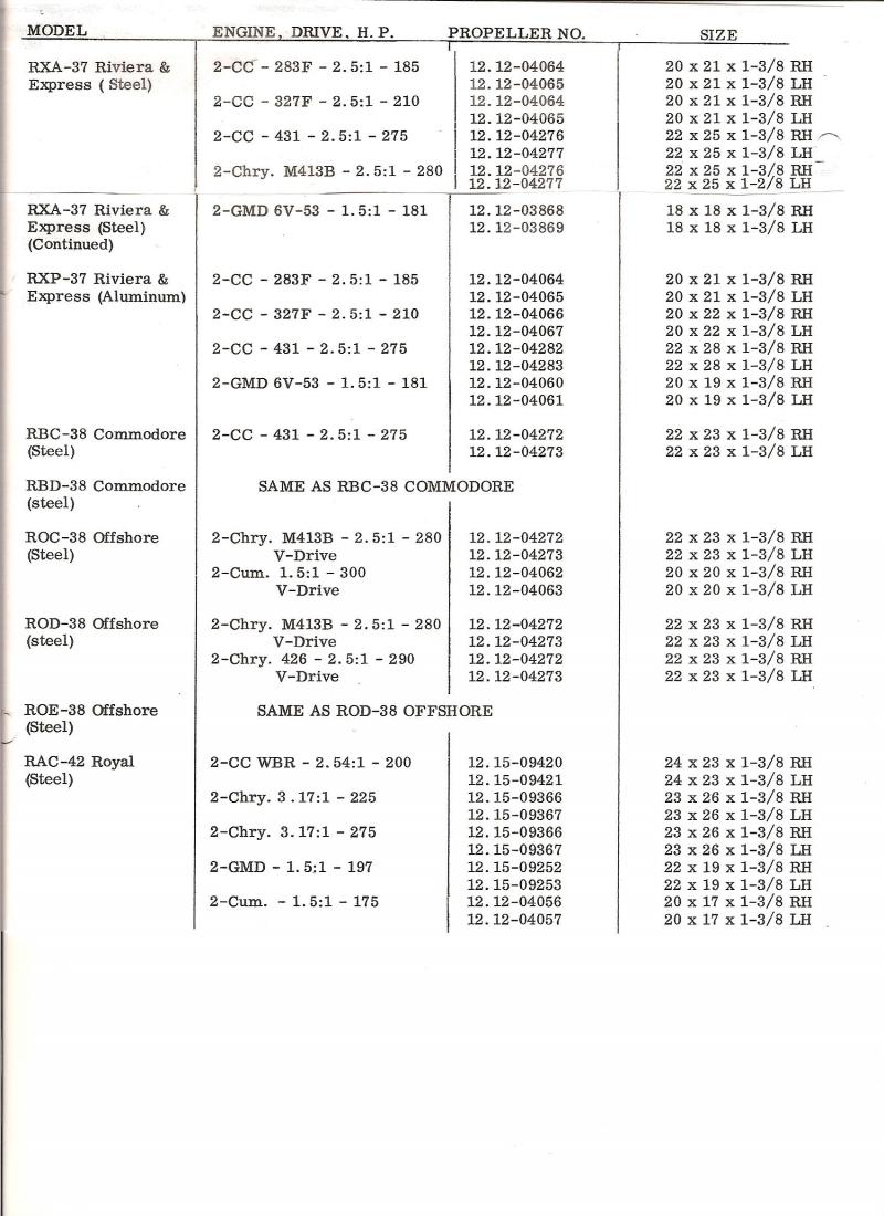

    prop chart
    attached is a chart for prop sizes subject to hull material and engine size. I hope this helps. This is for years1955-1965.

    The chart shows a Cummings engine used in some Offshore models. Does anyone know which diesel engine?

    Thanks for the the table I thought I had the original propellers for those days when it sat V8 gas engines in my boat, but now I know that they are replaced I have run the boat aground and I are looking for new on ebay :)

    In looking up my info it seems to match the table Rapple provided.
    The SN tags from my boat match at 4066 and 4067 which are for a 37' 1965 Aluminum Roamer Rivera 20x21x1 3/8 shaft.
    Thanks Rapple for posting this table as this confirms what I assumed was the original engine config of 327F 210 hp w/ paragon 2.5:1 trans. My replacements by the PO are 3 blade dynajet bronze 21x22 and a GM350 reported to be 250 hp.
    It seems this table is a bit older as it lists the 431 MEL but not the 427's which is what I am trying to approximate.

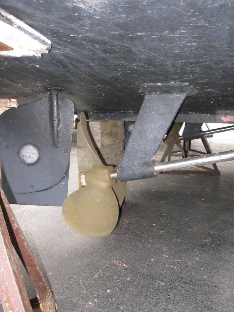

    pic of 21x22 prop
    Heres a good pic of clearance at this size
