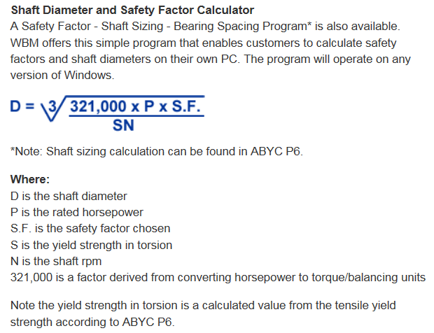

    The shaft calculation is easy and can be found at Western Branch Metals website: http://www.wbmetals.com/shafting.asp
    The calculation is:
    You want to have a Safety Factor of at least 5.0 for Diesel Recreational boats. the other properties are in their catalog, with the yield in torsion for AQ 22 Shafts at 70,000 psi for 2" diameter.
    Your Safety Factor for the 6V-71TA rated 435bhp @ 2300rpm (1.50/1 gear ratio) works out to 6.34 for 2" diameter AQ22.
    Your Safety Factor for the 6V-92TA rated 550bhp @ 2300rpm (1.50/1 gear ratio) works out to 5.01 for 2" diameter AQ22.
    Good news for you since you would not need to change shaft diameter (as long as it is AQ 22).

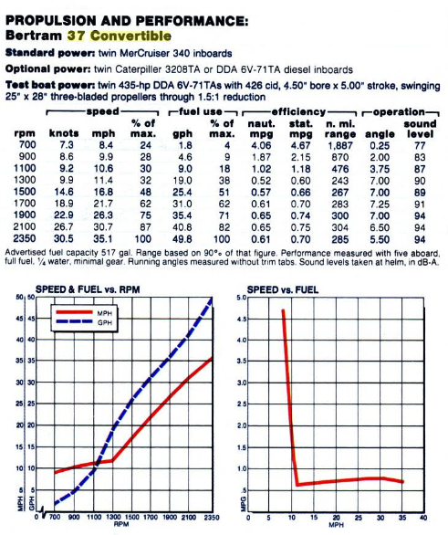

    As far as speed goes, here is the 1986 Boating magazine published test with 6V-71TA's:
    You should be able to compare your boat numbers to the chart above, but I would say a 27 knot high cruise at 2100 rpm is possible with the 6V-92TA's, although I like to cruise these Detroit's no higher than 1950 rpm myself for better longevity. Keep in mind that fresh water (Great Lakes) speeds are less as you displace more than boats in saltwater.

    Perhaps I have “light” boat, scales say it is 25k? At 1900 I’m at 24-25 knots and 2300 + I’ve seen 32 knots.
    In all honesty, it probably would be best (economically) to do a rebuild on current engines and/or buy a newer faster boat :) 531D3082-A5DF-41E6-8997-3558A6C12139.jpeg

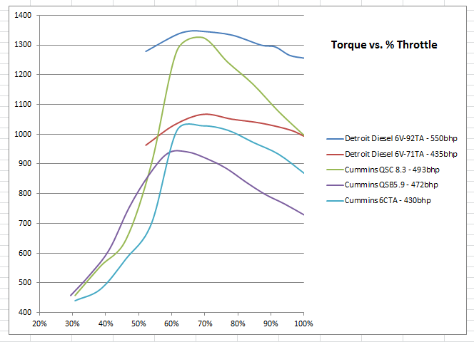

    Here is the torque comparison for conversation sake:
