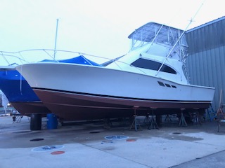

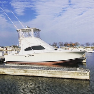

    Last fall when I pulled the boat for the season I planned on completely redoing the bottom. I had it blasted to gel coat but weather was not on my side and had to let it sit all winter. Finally had a window of opportunity to finish the job.

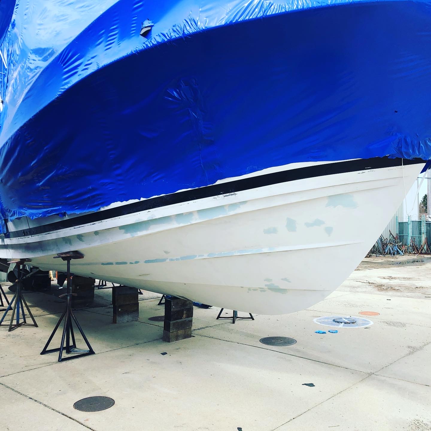

    there were a few patches of blisters that had to be filled with Interlux watertight. Based on their locations and that they were in consistent patches I assume they were just flaws from the factory.

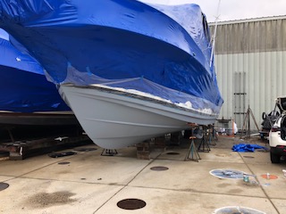

    next was multiple coats of Interlux 2000 barrier coat. I switched colors from grey to white between coats. Interestingly, the white was much more difficult to work with and did not spread nearly as far as the grey. Had to use almost twice the white per coat compared to grey.
    finished it off with 320 grit sand paper and spraying 4-5 coats of Interlux VC-17. Hindsight I would have done one more coat of barrier coat and sanded more first. Turned out smooth but I would have liked a bit smoother.
    A ton of work but in the end very happy with the final product. This is my third time doing this project but bigger boat everytime. I can see why the yards charge so much, especially the older I get!

    Ref. the blisters patches, let me guess: were they mostly along longitudinal lines, parallel to the spray rails and/or on the rails themselves?
    That's what you typically find on many traditionally laminated hulls, and normally is rather superficial, affecting only the gelcoat.
    If that is the case, after your treatment, I'm sure it will not be a concern anymore in the future.

    As far as the blisters, yes just as you stated Mostly along longitudinal lines and along parallel to spray rales/rakes. After seeing the pattern I assumed the same that they are not a major concern.

    Ref. the blisters, yep, that pattern definitely comes from the original hull moulding.
    A bit tricky to explain, but it's mostly driven by the sequence and timing of the manual stratification by roller.
    Rather common in traditional moulding, and has nothing to see with what is normally called osmosis.
    I mean, it's still possible to find hulls with this kind of blister pattern AND also "deeper" osmosis with resin release, but they are different things, with different reasons.
    The former being much less worrying than the latter of course, which in the worst case can even create structural delamination.
