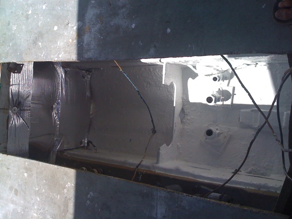

    bilge rat's

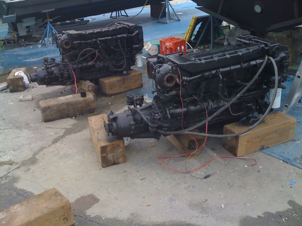

    So I pulled the diesel's out for a painting and to swap some stainless bolts on the flex plate to hardend steel. Then I also covered the whole bilge with awlgrip cloud wight same color as the top side and it stuck to every thing even the kevlar engine bunks awlgrip is good stuff brushed it out unreduced and gave me killer coverage.. I am close too splash down now... just have to have the shafts polished and put in the salon doors, interior, the ac/dc system and do a final fitment of the tower....

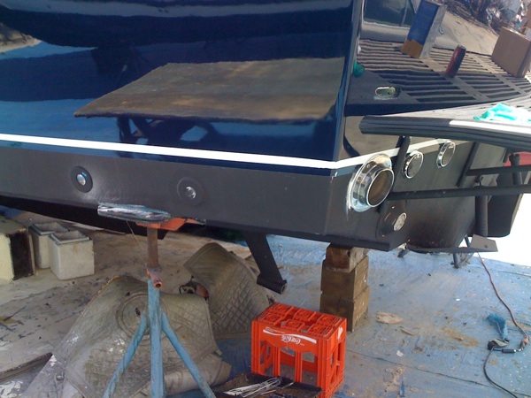

    one more hole in my boat
    Well two if you consider there are holes on both sides... As of now I am running fore x520's on the sides, two 1520's on the transom all super blue and one 3010 wight in the middle of the transom. I still have one more ocean led x520 flush mount super blue but do not think I will go to 3 per side, but who knows? I also have an extra 1520 blue, that will ether end up on the bottom in place of the use less drain plug or on the transom. Most likely I will end up buying one more of each and run two 1520's on the bottom and the two x520's on each side of the big wight 3010 on the transom, This will fill out all the water blue around and in back of the boats cockpit and and cause the much power full wight led to peak out past the blue in the back giving a neat effect...:) If you look in the reflection of the paint you can see I also pulled one engine hatch down and reinforced it with a layer of glass it was flexing a little and the final wood flooring may have fixed it but at $50 a foot for solid mahogany marine flooring I am not risking it...

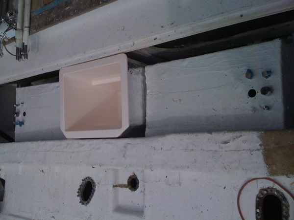

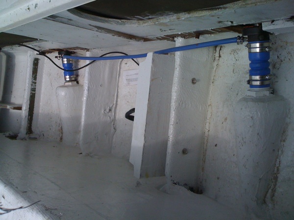

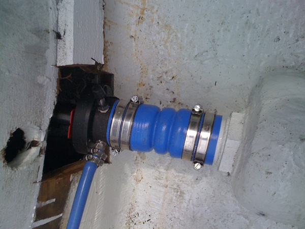

    stainless housings, speed & dripples seals
    so the stainless steel rudder housings got finished to day an were test fitted punching the whole ate 3 saw blades in each housing but its nice to have a set of solid rudder housings that will not flex or rot with time.. I also get my shafts back tomarrow, and I will give them all my info and have them give me a idea of my top speed with the new diesels. Even with all the extra outfitting on the boat I think the composits will still reduce my weight below the factory weight but will still use the factory weight for my base.
    also got the dripples shaft and rudder seals. any one have a big prob with a dripples system?

    The dripless seals are nice for a dry bilge. Although from what I've seen on two different boats lately, one was a 2000 and the other a 2001. The tideseal ate into the prop shaft 40 thousandths (525hours on the engines)and the shaft had to be replaced when replacing the seal, the portside shaft was ok. The other boat the tideseals ate into the rudder posts and the rudders needed new posts welded on, otherwise the new seal wouldn't seal properly. But I guess after ten years it's not a bad thing. I hear better things about the PST system over the tideseals.

    Thanks for the info.
    Why do you think the seal ate the shafts?
    Was the cutlass insert worn out?
    Was the shaft damage a twin engine set up?
    Was there a cross over tube on the system if it was twin?
    Was it run on one engine if it was a twin engine set up with no crossover tube?
    Was the cooling line clogged?
    Why do you think the rudders were damaged?
    Was it there j type?
    Was there heat damage or sine of Lack of cooling?
    Did the rudder housings have play in them?
    Both systems ran un-till they leaked?
    Both systems were used 7 to 10 years?
    Both systems were trailer or slip boats?
    Both systems were used often or sat?
    I am only asking cuz I just dropped a lot of dollars with tide for new shaft & rudder seals and rudder bearings Friday....
    Thanks
  8. Capt J
    14,892
    The material in the Tides that rides on the shaft is very very hard. The engine that had the tide that ate into the shaft was slightly out of alignment, which maybe caused the tide to bind slightly on it. No crossover tube. The engine with the leaking seal was always running when the boat was used, the cooling water line was not clogged. This was a slip boat a 2001 34' searay with 525ish hours, twin 8.1 liter mercruisers.
    The rudders had some play which also was a tide bearing plate that held them from being loose near the top of the rudder. This was a slip boat 50' Post SF a 2000. Used often with 3500 hours on the engines. Both rudder posts had the same amount of wear. I think the rudders were damaged because of the hardness of the tide seals, and they're not water cooled or anything. I am wondering if they had a grease fitting if it would help.

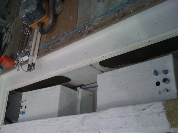

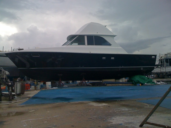

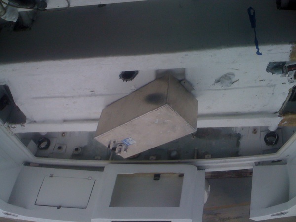

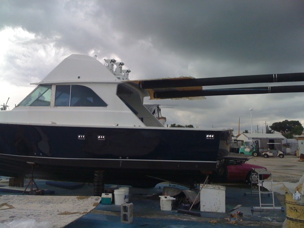

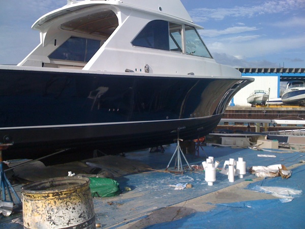

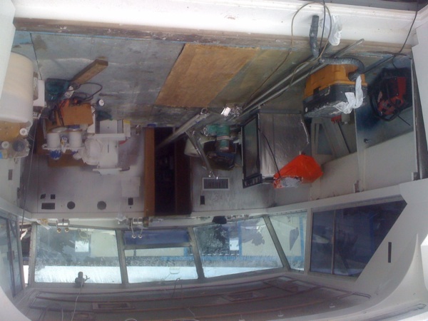

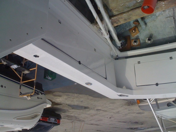

    some more stuff getting bolted and glued
    moving on:) the boat was moved next to me so it was time for a photo. shot 2 the fuel tank is painted and the un glassed alu svo tank is watting for a test fitting. shot 3 the salon floor is all down no missing hatch to fall into!!!!

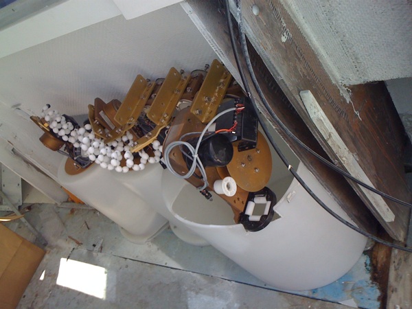

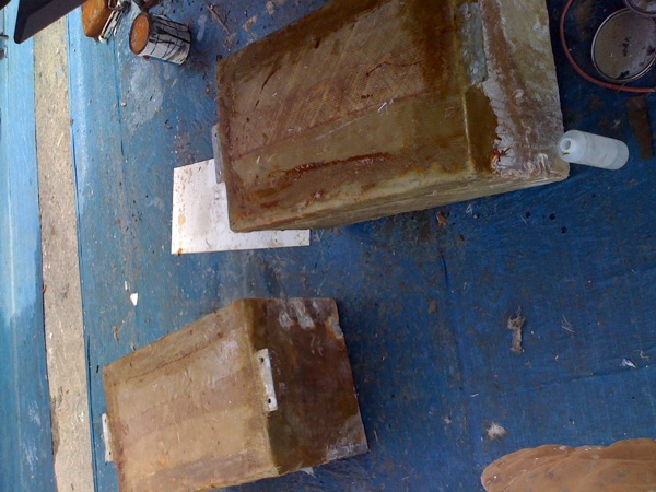

    seals and tanks and stuff
    so photo 1 is the two 60 gallon SVO tanks being glassed for to prevent rot. shot 2 of the seal installed and shot 3 is the bunks going in and the two shaft seals

    some mor installing
    shot 1 the first SVO tank is in place with a lot of room to get to the drip less seal.:) shot two both the tanks with there fresh coat of awlgrip are bolted into the glass bunks and ready for pluming. and the last photo shows the cruisair cooler installed in between the two SVO tanks..

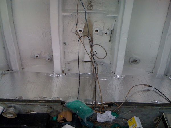

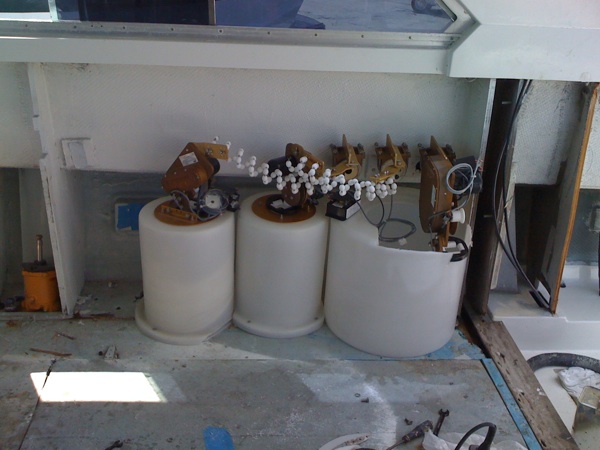

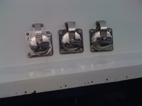

    installed cablemasters
    so I got all three cablemasters installed two 30 amp and one 50 amp

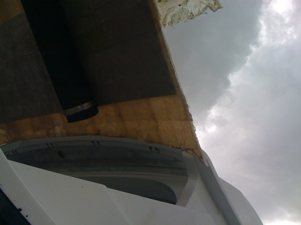

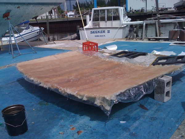

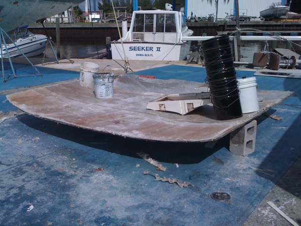

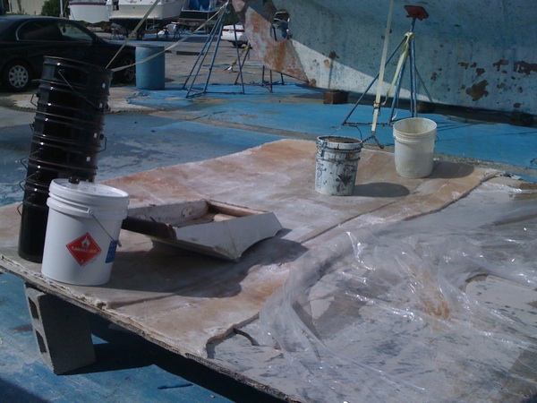

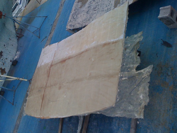

    cockpit hard top
    well I have to put the tower on to rig the pluming in the boats and I want a cockpit hard top to get me out of the sun and hold up the tower & 4 or 5 guys. so I started building it today. I used the inside of the fly brige hard top as a mold. I used the flybrige floor to make the flybrige hard top so it an exact copy and the cockpit hardtop will extend the floor 7ft when in the down poshion. Its 16mm nita core with 3 thick layers of glass on each side fallowed by 1/2 dyvinacel and 3 more layers of glass. the 1st shot shows the nita core with 3 layers of glass sitting in the hard top...more photos to fallow.. the 2nd shot is of the dyvincel foam core being pressed to wet fiberglass on top of the nita the 3rd shot show how it will fit plush to the fly brige floor or salon roof...
    I flipped it over and glassed the top also to day but the rain starrted moving in and had cover the project till to marrow whel well test fit.....:D

    hard to test fit
    with onl layer of glass on the top side of the hardtop we test fitted, the first shot shows the top sitting on some saw horses, the second shows how far to will extend and the third shot is of how it will line up with the existing top...

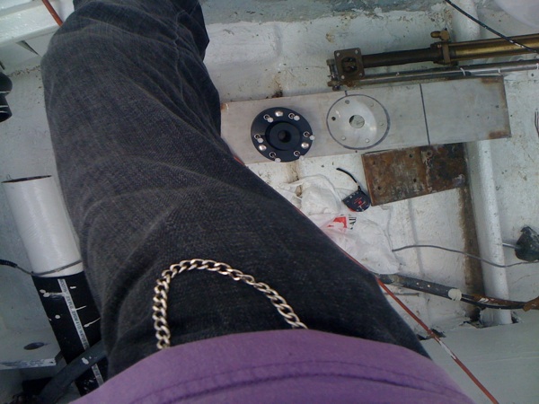

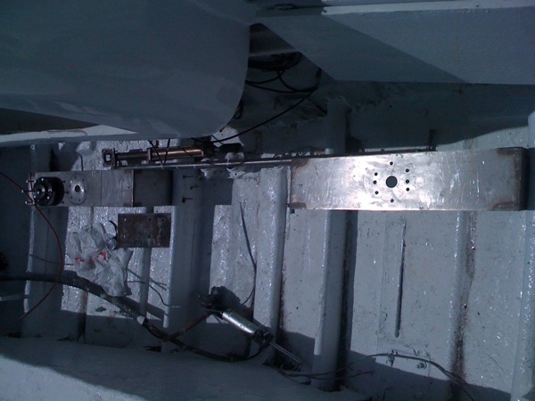

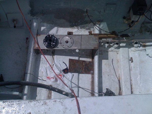

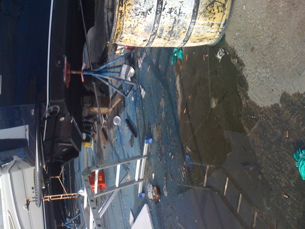

    stainless rudder housings
    the first shot shows the two housings installed the second and 3rd shots show where the ram will end up and I will need to add a plate to bolt the ram on..
