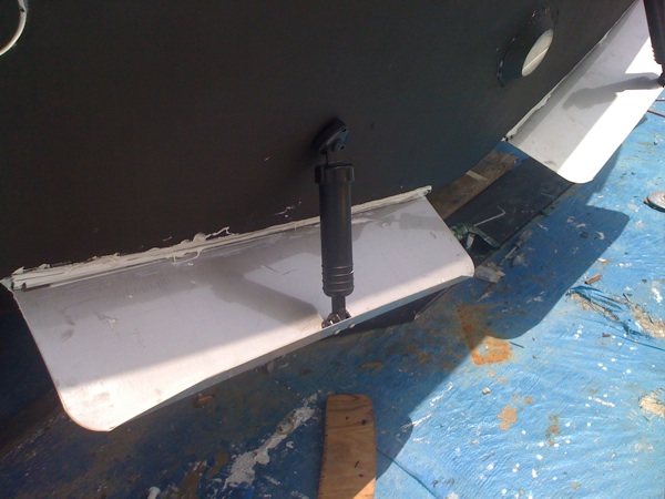

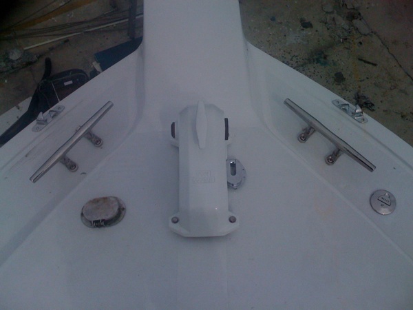

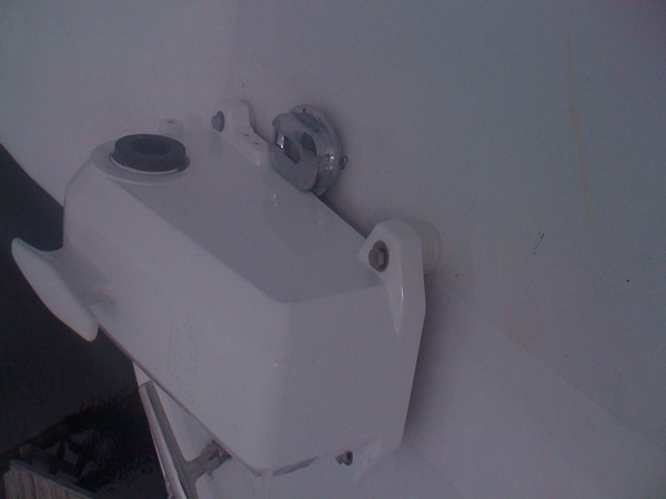

    stainless thru hulls and muir windlass
    here are some in progress shots

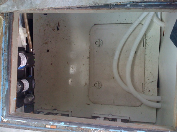

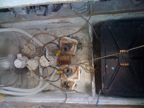

    dirty bilge
    getting it all in place

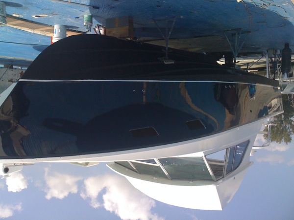

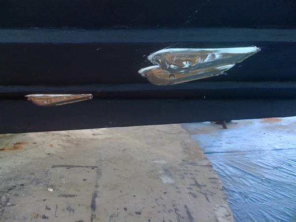

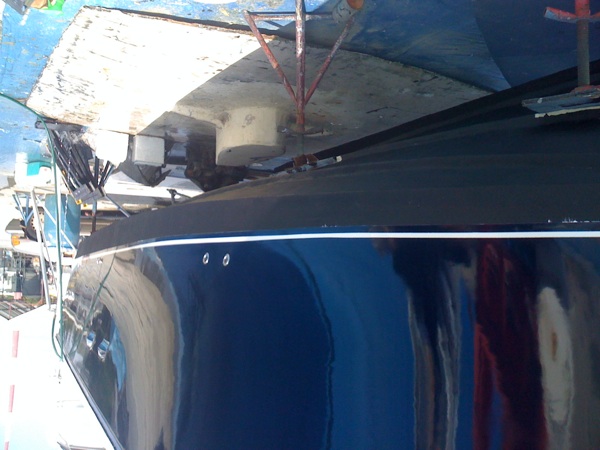

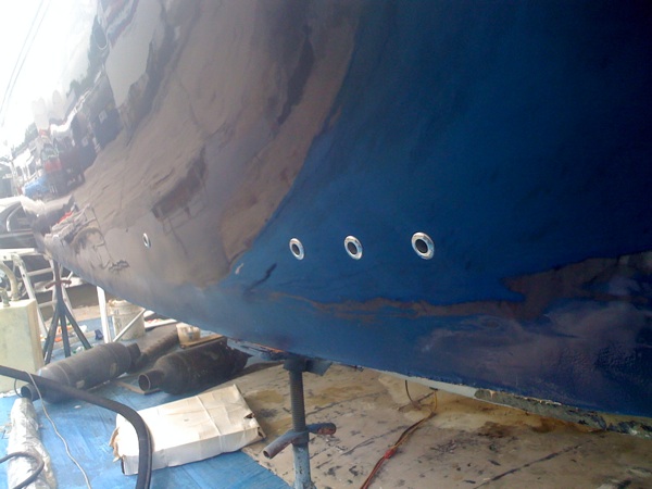

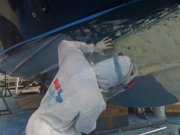

    interlux 2000 then the micron 66 & the water line
    love the smell....

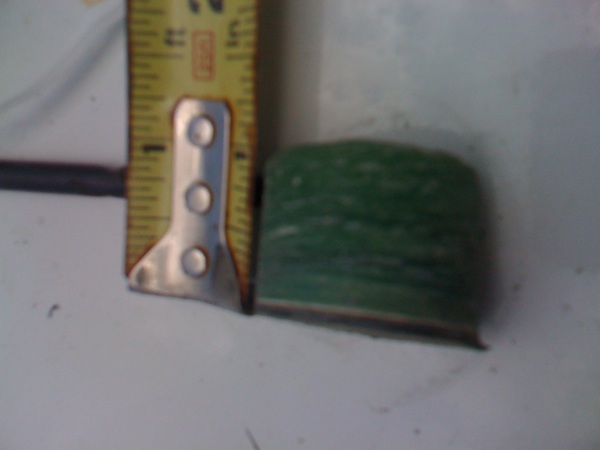

    water line and hull cores...
    the thickest is next to the keel 1 1/4 the second is by the side on the bottom for the sink drain 1"

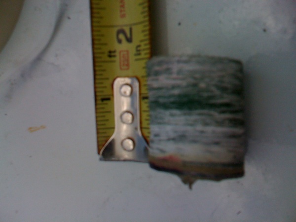

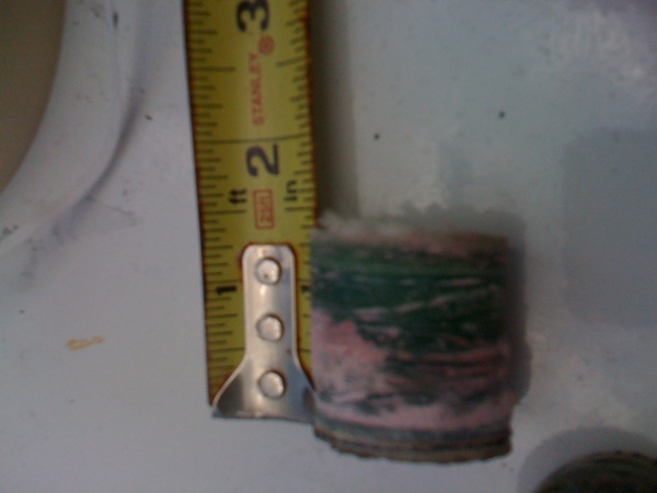

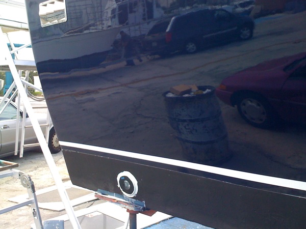

    transom bottom core & stainless passage bomars
    1 1/2" solid!!!!!!!!! note the 1/16 carbon barrier coat...

    What a great job you are doing, so complete! I have a '76 35' and my water tank has given up the ghost. It's aluminum, I've been patching holes for awhile but too many now. I was think of cutting a large piece of the plywood out, on top of the tank, then cutting the top off, cutting the baffles out, and installing a bag right in the tank. It sounds like you took your whole tank out.
    Can you tell me what kind of a job that was? Did you cut the plywood out so you could see the entire tank? Did you take the tank out in pieces?
    Jon
  12. 35bert
    35bert New Member
    May 27, 2009
    86
    daina
    Thanks Jon
    The ez way will be to cut the ply wood in between the center two stringers.. Take a whole saw or some thing to give your self a nice size pilot hole then use a reciprocating saw to cut the two sides along the inside of the stringers. I'd use a demo blade or nail in bedded blade, Do Not Cut the Stringer!!! give your self room when you cut blind and clean up once you have a hole you can see into... And you may need a hammer or crow bar to bust out the corners, then you can pull the old tank out and drop your new bag in... If the old lumber gets trashed and it may or will, just cut a piece of 3/4 or 1/2 ply about an inch larger then the hole and screw it into the old ply wood that is still in place. When you do a project like I did a full refit you do not have to worry about scratch paint or braking stuff a crow bar a sledge hammer takes it apart fast what comes off go in to the dumpster... Only after she rolls out of the paint both do I need to worry about every thing a boat owner worries about so I think my view on any one job is a little bent, its all just a blur and as a whole its years of my life. Restoring a boat is like fixing an old 4 sided house that has to move 25mph in the water. Don't get me wrong it was fun but now I just want to go fishing. :D

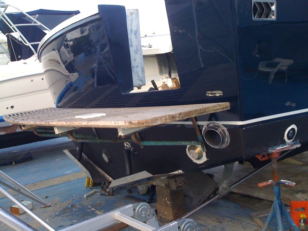

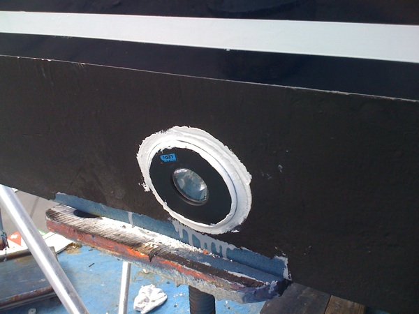

    well I put on some tabs and stuff like the ocean led lights, and the platform test fit.
  20. 35bert
    35bert New Member
    May 27, 2009
    86
    daina

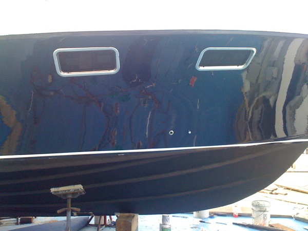

    ocean led
