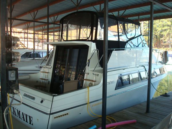

    I just purchased a 1993 330 Mariner, this is the first boat that I have no idea where to place the TV antenna??? It has a cable jack on the back wall of the cabin above perko switch, even a jack in aft cockpit...
    Anyone know where the cable goes or any advice where to mount the antenna and find the other end of the coaxial?
    No signs of Antenna in the past.
    Thanks, First Carver...
