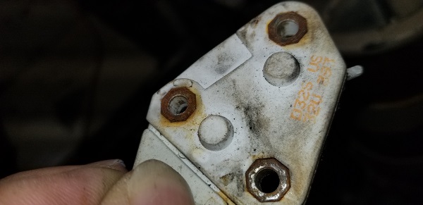

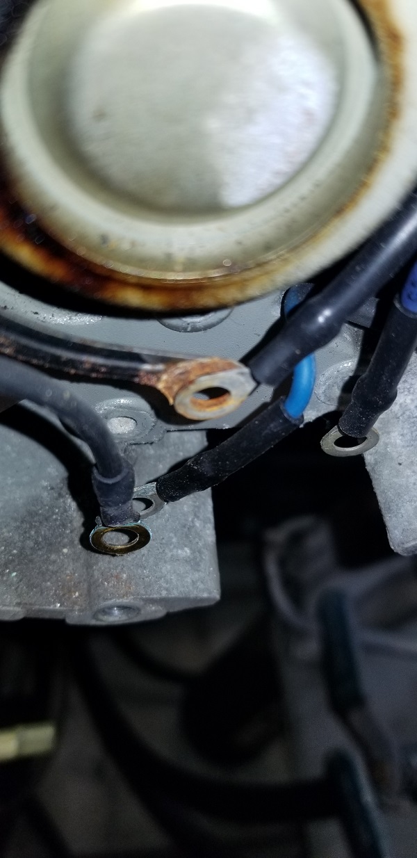

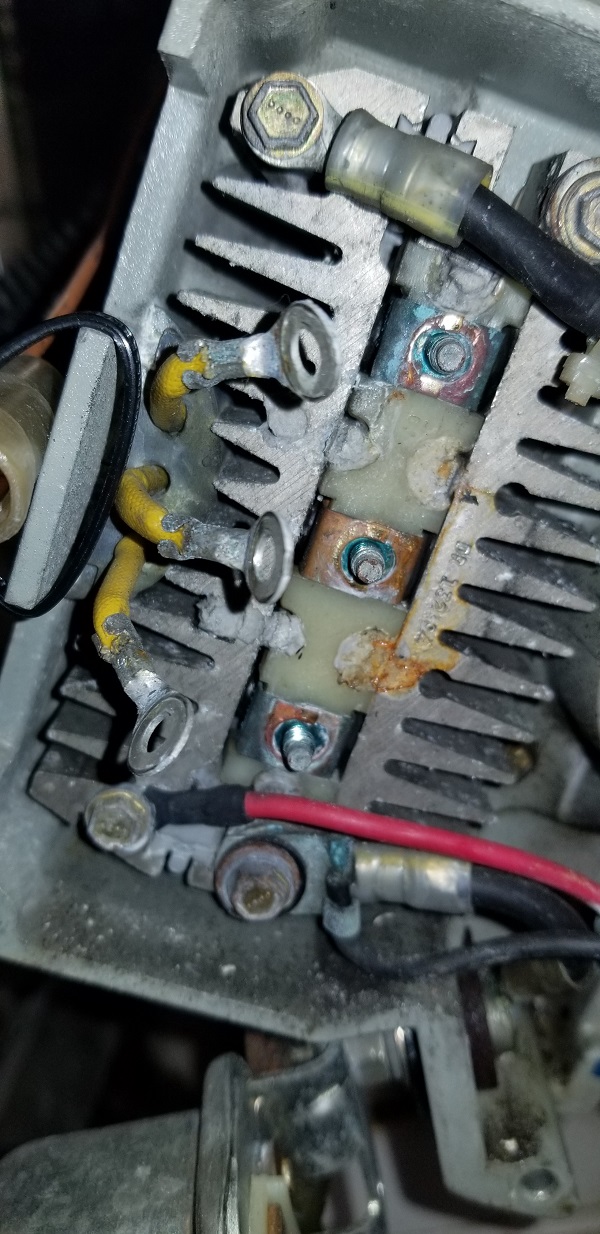

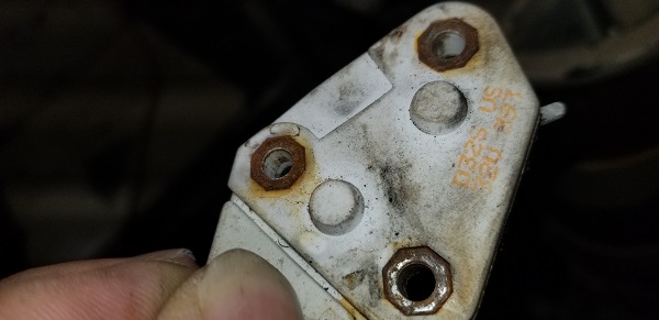

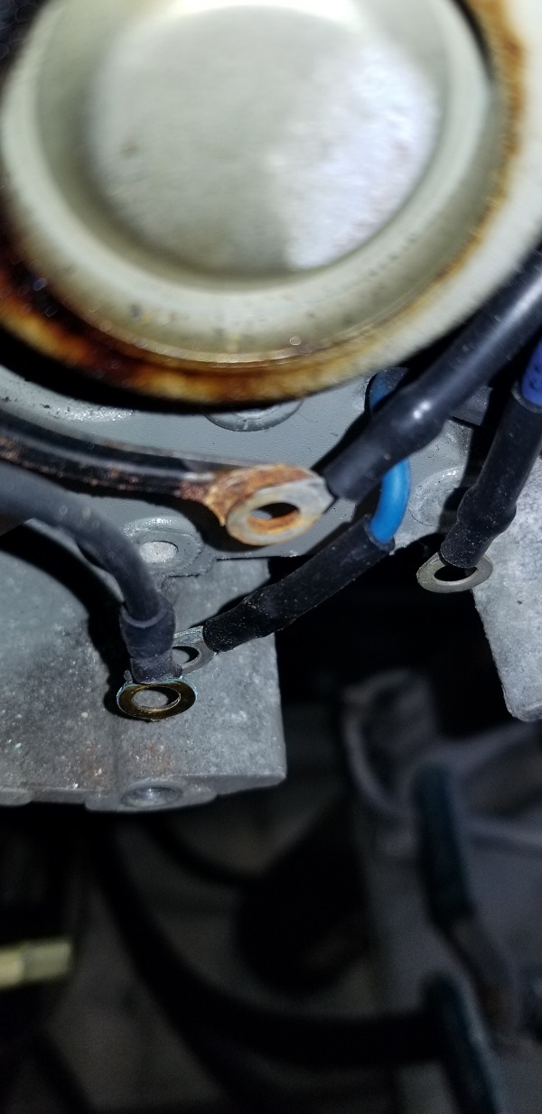

    So my starboard, 32v, 30SI alternator stopped working 2 weeks ago.
    It is a brush less unit and usually very reliable. But now, just sits there and does nothing.
    I have a large diode charge isolator that allows for the port engine to help the stb batteries so not an emergency, just the port engine is taxed enough with an air compressor and second alternator for the inverter 24v bank.
    Lets fix the stb alternator this week.
    While still bolted on the engine, it is mounted on the port side of the stb engine. Just slide up a 5 gallon oil pail, have a seat and 99% is in hands reach.
    Once I removed the back tin cover, I immediately reached up for a drink. What have I done to my poor lil alternator.
  2. Capt Ralph
    13,121
    During my PTO seal service, Coolant was drained, All was rinsed off with a fresh water hose,,, AND SAT while I replaced the oil seal, serviced the H/E, replaced the old hoses and reassembled all.
  3. Capt Ralph
    13,121

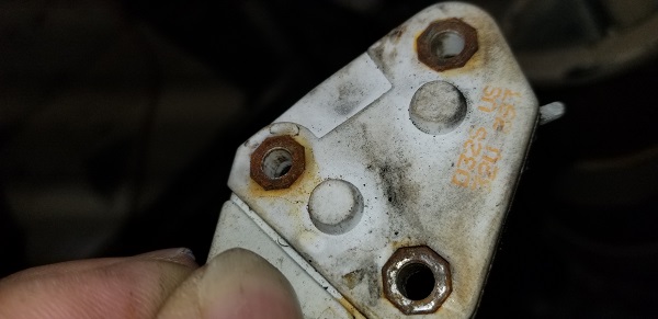

    Pulled out more bourbon, contact cleaner, brass tooth brush and cleaned it all up.
    This evening I am so happy to report to Josie (wife) that we don't need to order a new alternator.
    Whewwww
    Seems there are no rotors or stators around (this week) for rebuilds. Nobody wanted to offer a rebuild/exchange.
    My cost on a real Delco, new, 32v, 30SI was $550 plus tax and shipping.
    So, near a bottle a hooch, half can of contact cleaner, old fingernail file, lots of naval language, darn lil thing is working better than before.
    Reminder to all, Blow your alternators out with compressed air or WD40 after a hose down.
    Or call me, cover my bar tab and I'll have to fix it.
