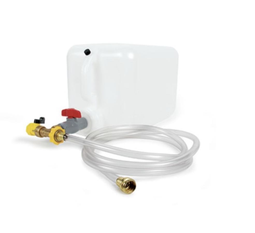

    Was planning to have a barrel of it in the salon and just connect to hose to the intake side of each engine

  10. Capt Ralph
    13,866
    And do what?
    With what you provide so far, I'm I'm guessing at what your doing;
    You think a lighter liquid is going to push the heavier sea water out of your engine and get charged with the antifreeze from a few foot drop?

    So with the engines at idle speed the contraption I posted isn't enough to feed the cooling system on it's own to winterize?
  15. Capt Ralph
    13,866
    You did not mention with the engine at idle.
    With that, your going to need more solution than in that jug.

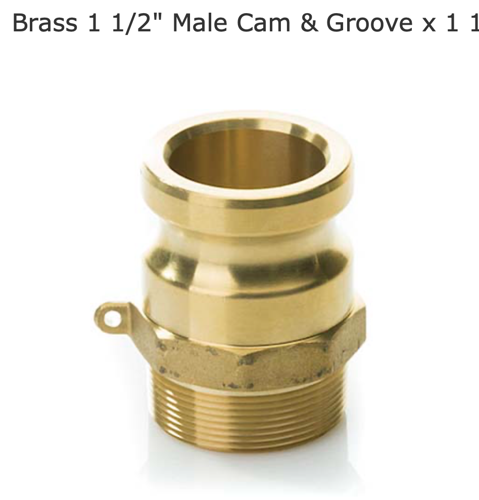

    Thanks for the feedback guys. At this point I'm looking at plumbing a 1-1/2" cam-lock fitting into the raw water line on each engine and using a 30-gal tub to flow the antifreeze in from above. I think this will be sufficient at idle to feed the engines and winterize. I want to avoid a pump since the seacocks will be closed and I don't want to force feed the system or impeller.
