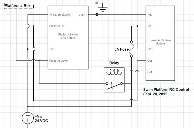

    Hello,
    I did go with the Lewmar setup. One aspect that became an issue is that it has a max of 3 amps that it can handle.
    The solenoids on the hydraulic pack run at about 2.5A. And so far I'm good. But... On the down activation side of the platform you've also got the safety latch solenoid drawing 5A.
    So I had to install a relay to avoid maxing out the module.
    I've attached a schematic in case anyone is interested.
    It's fairly easy and straightforward.
